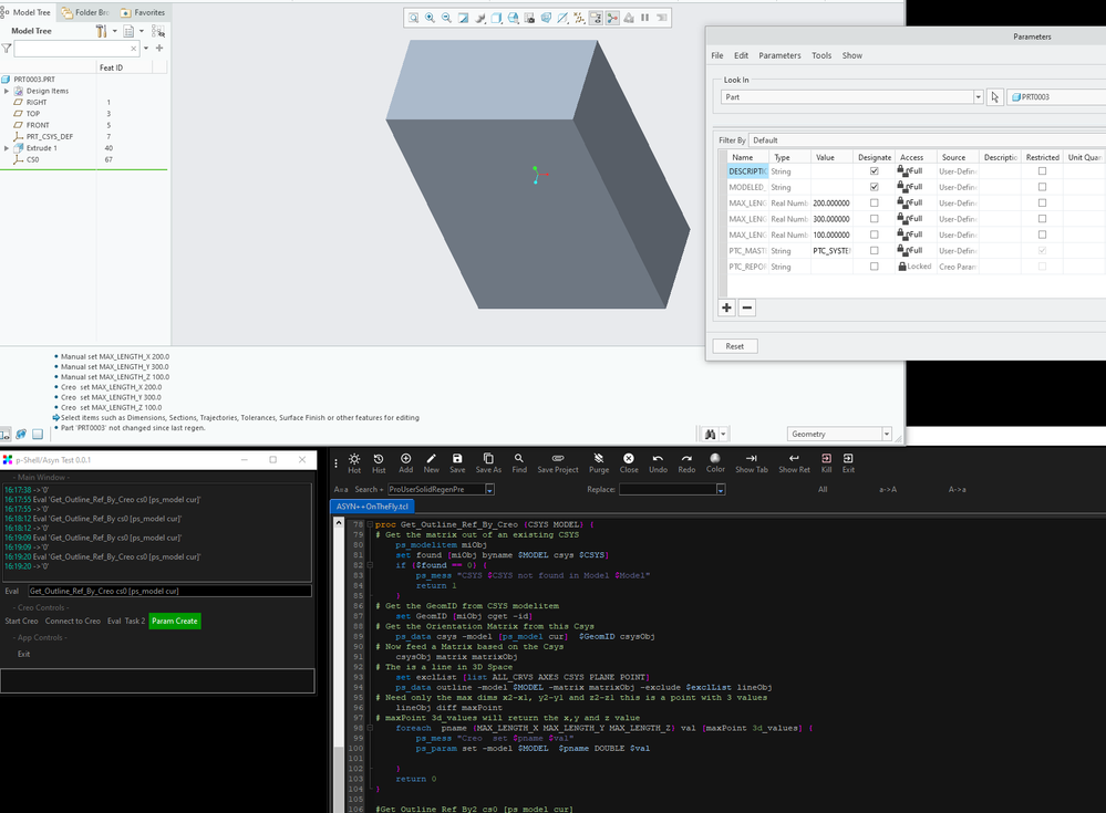

Here a screenshot

Luca_Carraro
(To:RPN)
Hi RPN,
sorry for my delay.
Many thanks for the solution,.
That's what I need but how do I turn it into a command,
Could it be code written inside a trail file?
I don't have these programming skills.
How you can turn it into usable code?
thank you very much for your time, many greetins, Luca.
