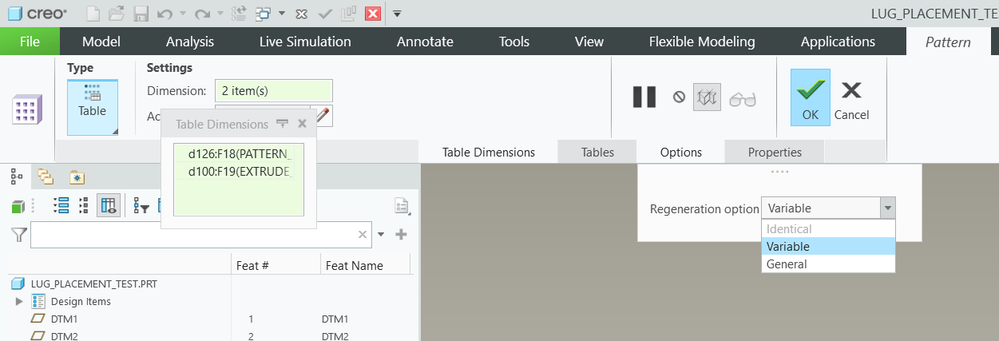

I have a table pattern with 3 members, the third member is failing but I have not been able to root cause the failure. The pattern regenerates when only varying the angle dimension (ROT DIR 1), when I add the linear dimension to the pattern it is failing.
I am looking for options on how to determine what is wrong. If anyone has suggestions for diagnostics or can see the issue, chime in.

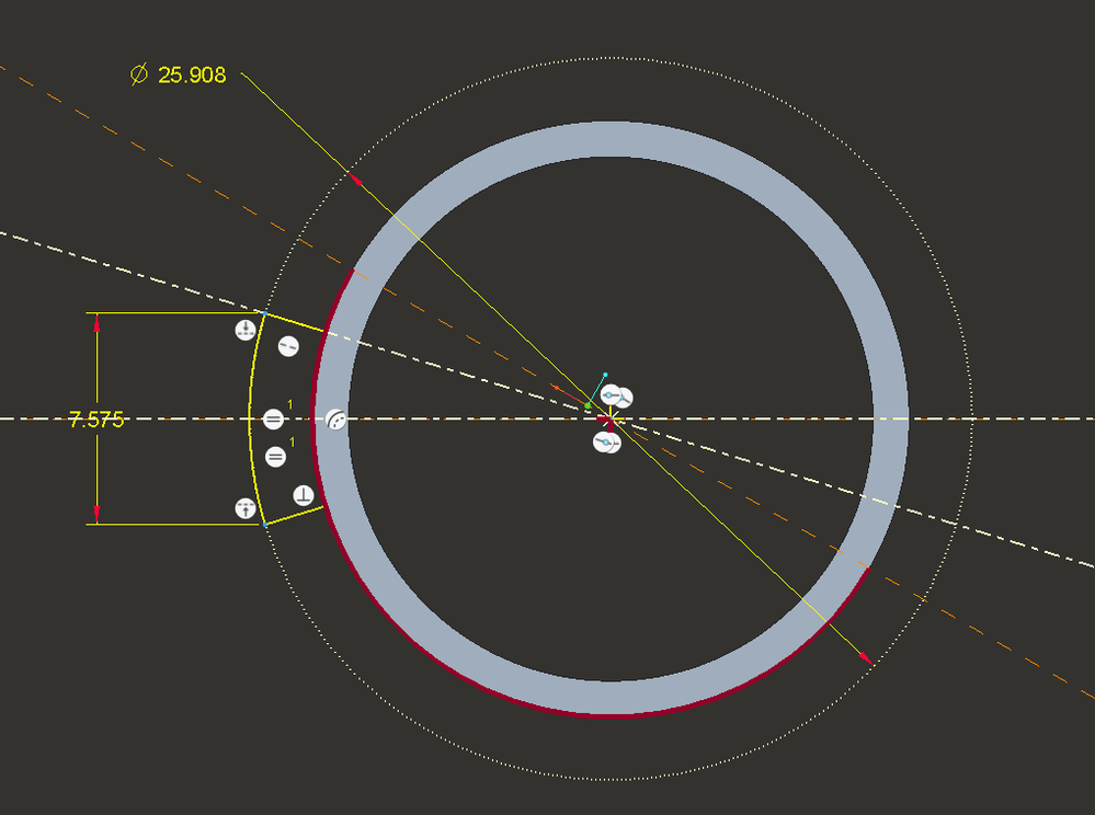

It appears that @Patriot_1776 may be correct about the curse of the split circles contributing to this.
This is the explanation I got back from R&D on why the intent chain is failing and the edge is not. In this case intent chain for the full circle is not more robust than using an edge of the same arc.
“Section of the first pattern feature uses Intent Chain as a reference.
When the first instance is regenerated, this intent chain forms a circle - fine. But this extrude modifies the edge that this intent chain is based on.
When the second pattern instance gets regenerated, the intent chain is an arc - still fine. But this extrude breaks this arc into two and now the intent chain contains three arcs.
The third instance sees three arcs in the intent chain and fails to regenerate as Sketcher doesn't support projections of intent chains with multiple components.
This is the expected behavior.
Users can easily modify the section so that it doesn't use intent chain reference but just uses an edge (which is used anyway, in that sense the intent chain is redundant in the original model).”

The table pattern regenerates until modifying the second dimension (lug width). See enclosed video which was shot using Creo 9 to verify the issue is not unique to Creo 7.

tbraxton
(To:kdirth)
I think I found the issue. I was using an intent edge for the OD of the boss wall. You used edge (1/2 the circle) in your sketch. When I modify my sketch to not use the intent edge it works with both variable and general regen options. Definitely seems like a bug as using an intent edge should be more robust than an edge.

Patriot_1776
(To:tbraxton)
'Sup Tom!
In general, if a pattern fails, it's because a reference gets lost or corrupted.  I've run into this BUG, and, as I've been complaining about for many years, it is because Pro/ENGINEER (Creo) STILL cuts circles/cylinders/spheres in half.  This is the root cause of MANY failures.  A Pro/WORKAROUND is just using the arc as a reference, and sketching a new arc using the centerpoint and equal radius.

tbraxton
(To:Patriot_1776)
My use of the intent edge (which includes both halves of the circle) should prevent the loss of the reference as you describe it due to split circles. The fact that the pattern regenerates using the variable option suggests that it is not losing any sketch references as all of the members are regenerating correctly along with the pattern. It really looks like something is not working correctly with this use of an intent edge.
There is now an open SPR 15808525. I will report back with the response/resolution from R&D when I get it.

tbraxton
(To:tbraxton)
A workaround exists. Changing the pattern regeneration option to variable results in success with the pattern. This however I think is a bug as the "general" regeneration option is a more permissible domain for regeneration, variable is a subset of general. This looks like a bug to me. Thoughts on this quirk? Same behavior in Creo 7 and 9.
