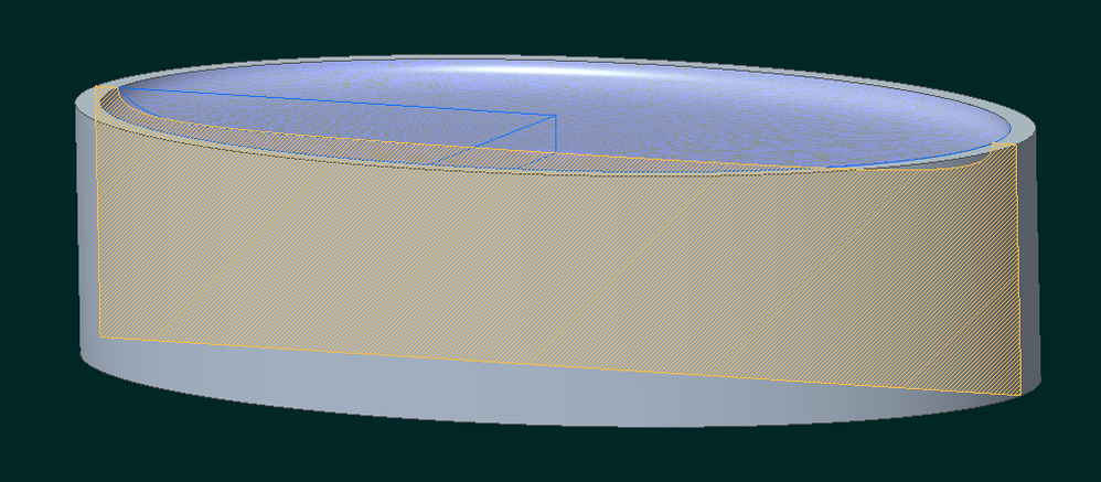

While crafting this "toy" CAD model to answer another question on this forum, I re-discovered the curious issue that one sometimes encounters with models which "goes away" if you play with the model accuracy.
The dimpled top surface is generated by (graph-driven) variable section sweep.
The model works fine if the absolute accuracy is 0.001 (or greater?) - but fails when it is smaller...
The model in the attached zip file is failing as it was saved with absolute accuracy value set at 0.0001.
Isn't it concerning that increasing the fidelity of the model breaks it?
This model made in Creo 4; I'd be curious to hear whether such problems are not encountered in newer version of the software.

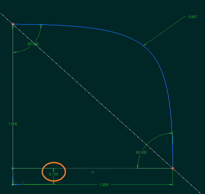

Using the graph to drive the sweep in this manner is not something I would have even tried as I expect it would not work. IME the sketcher does not usually work when forcing curves to adopt a zero length. IDK why it works at all at any accuracy setting but I suspect that a coarse enough abs accuracy somehow avoids the zero length curves. I would be pleasantly surprised if PTC came back and said this is a valid approach to driving a sketch as it is quite useful.
In Creo 7.09.0 it will regenerate down to 0.0007 mm absolute accuracy. Below this value the regeneration fails, and command line reports the following error which is likely the evalgraph function.
Line 1 Section of model TOO_MUCH_ACCURACY_FAILS::Probable error in function evaluation.
I suspect it is related to the fact that your sketch requires that within the VSS sketch that SD3 and SD 6 =0 at the full depth of the cut out.

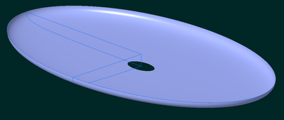

Hi @tbraxton, having VSS sections that have segments / elements that are/become 0 length as the trajpar parameter  evolves has been something that always worked, IME.
Anyway, I don't think that's the issue here because if I modify the graph so that the 0 size ellipse does not happen:
--> the model still fails for when the accuracy value becomes too low, with the same error message.
It seems the problem is more related to the 90 degree angle at the end of the graph curve.  For example, with this graph:
The model works all the way to the minimum accuracy value of 4e-4...
So I think the bug is more in the graph evaluation code.  Maybe it thinks that the graph is "non-functional" (i.e. 2 y-values for the same x-value) at the end?

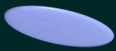

Last test that supports my hunch: by setting the angle at the end of the graph to 89°, these artefacts appear:
Maybe someone from PTC can take the content of this thread to R&D and they can file their own bug report and prioritize its resolution accordingly.

I got a very limited response from R&D. I have followed up with questions based on the response below. If anyone has questions related to this response, let me know and I will try to get an answer.
The user applied accuracy to less than a micron meters(half micron) for a part of size 482 mm, more precisely with relevant dimensions approximately 200 X 100.This looks beyond the range for which Creo was tuned to work efficiently.
More important this is a sweep in which sections degenerate – the ellipse at “the bottom” (trajectory end) becomes a point.
The sweep is done by creating (regenerating) sections along the trajectory and “connecting the dots” (sections in this case) – creating a surface through the sections.
I assume that in this case, because of the tight accuracy we are forced to construct sections very close to the end/singular section, and that the dimensions (ellipse semi-axes lengths) in the sections themselves (other than the end section) get below the tolerance the sketcher allows.
90->89 degrees change in the graph attempt that change, in turn, somehow changes the rate of change of the dimensions near the zero value (at 1.0 trajectory parameter). and so works

Follow up response from R&D on this:
First, the graph is vertical (tangent to y-axis) at point 1.0 – it means the infinite derivative. I don’t think we like such a thing. Also, it explains why it works when we change the angle from 90 to 89 degrees.
Second, the graph evaluates to zero at param 1.0 which yields zero radiuses of the ellipse and it becomes degenerate. Maybe it is OK for Sweep feature, but I am not sure how stable it is on both Sketcher and Sweep sides.
The accuracy plays a minor role here, it defines a luck. When it is small, we perform more evaluations around traj_par 1.0 and face the issues of infinite derivative and degenerate entity hence the failure. When it becomes bigger we might just skip the problematic points. But playing with the accuracy is not the right way to solve the issue. It is the design that should be fixed.
