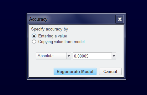

Just to be sure, you also altered the accuracy_lower_bound setting?
About part accuracy settings in Creo
cstrabley
(To:pausob)
Thanks for the reply pausob.
Yes, that is at the max allowed of 0.0001.
I go here when I have to:
default_abs_accuracy .00005
enable_absolute_accuracy yes

But on occasion, accuracy will throw you a curve ball and something will not regenerate with a superfine accuracy and will regenerate with a much coarser accuracy. It only takes a minute or 2 to try a few values and may help.
cstrabley
(To:StephenW)
Thanks, I have tried about 30 accuracy settings, and switched between Relative and Absolute, even though there is no import geometry.

Relative accuracy should be adequate for any developed part.
Absolute is best suited for when geometry/objects are being imported.
At this point, I am trying everything.
