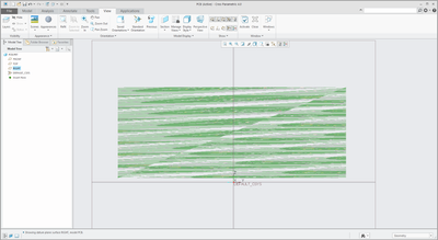

Trace sketch image problem
nwb10
2-Explorer

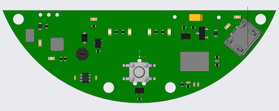

I'm trying to trace an image in creo. But when I import the image, the image appears to be in this distorted patterned layout. The right image is what I want to import. Does anyone know what's wrong?
Image is in PNG

Image attached to post is working for me correctly.. possibly a graphics issue. Try setting config option graphics as win32_gdi
That solved the problem! However, I also noticed some lag.
I did some searching and apparently win32_gdi does not use graphics card? I'm running a GTX1050 and it is up to date, do you happen to know which settings I can tweak to resolve the issue? Currently all settings are at default.

ok, with this option slight delay is expected...  in that case you may need to check the machine details at https://support.ptc.com/partners/hardware/current/support.htm
Possibly this is not a supported graphics card to work with Creo.
You may try below options, instead of earlier one.. if that helps.
 enable_opengl_fbo no
enable_opengl_vbo no
enable_opengl_shader no
That solved my problem completely, appreciate the help!
