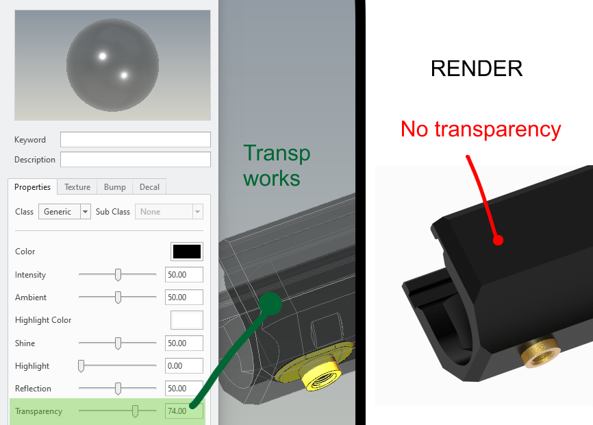

I have defined transparent model and it looks OK but when trying to render it then transparency is ignored.
Any idea why Creo 10 doesnt support it?
2 REPLIES 2
Van_AG
(To:PetrP)
You should change appearance class from "Generic" to 'Glass'
PetrP
(To:Van_AG)
Found this case https://www.ptc.com/en/support/article/CS276472
Glass is a solution but not suitable much for my steel parts...
