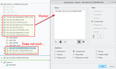

I'm not sure how to explain this problem, but I'll give it a shot (I can't share the files, I'm afraid).
I have a main assembly of a machine. This assembly contains several sub-assemblies. Two of these are the same assembly, but does have some interchangeable parts through a family table making them slightly different. The issue is that I can't change the parts on one of these without changing on the other one. In the main assembly I want to be able to show both configurations at the same time.
See it as a car where you have one subassembly for the wheels with the same rims, valves and caps for all, but you want to replace the tires only on the rear axle. Is this possible or do I need a separate assembly for the wheels with different set of tires?
Can I create a family table in the top assembly that somehow controls each of the subs?

I was trying to get this to work, but it seems only first-level subassemblies can be picked as columns in the Family table. Am I missing something?
Also - which "instance name" are you referring to (in part 3), regarding entering it directly into the table cell?
Yes, as far as I know you can only specify the family table instances of "first level" components, or components that are directly defined by the current assembly. To do the next level of components, in the very rare times I've had to go deeper like that, I've had family tables in the "second level" assemblies, too. It gets a bit confusing, I suppose, but I just have to be very careful about what I'm defining. I don't know what kind of horrors it might cause with Windchill (if any), because we don't have that.
I sorted it out, using Instance names instead of Yes/No, as you suggested. However, I needed to reduce one level of assemblies make it work, which fortunately was rather easy.

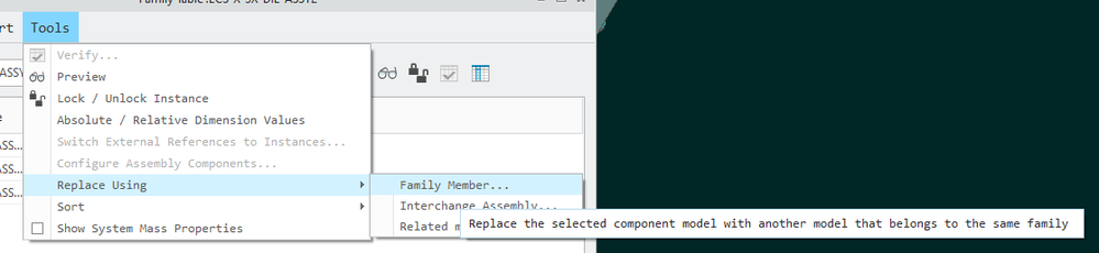

In case you didn't know (the spelling ?) , the Family Table editor UI does offer a way to specify the component instance to use for a particular assembly instance you are defining:
(Select the cell and instead of typing in Y/N/*/the name, use the menu function above)

Oh, look at that! 🙂
