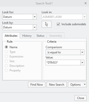

Chris3
(To:hvyas-3)
Use the find tool to find it and then proceed from there.
