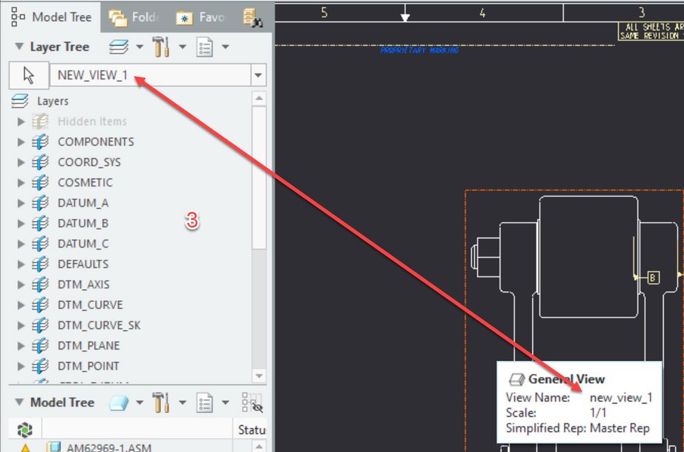

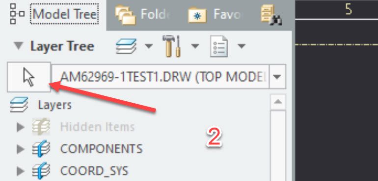

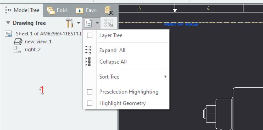

You can select layers to turn on and off models and other information per each view. Follow the images in order.
1. Pick layer tree
2. Use arrow to select the view
3. The view name is shown in the layer tree
