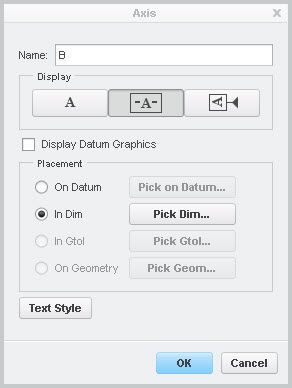

Can someone please explain to me how you are supposed to set the placement of a datum in creo 4. The "set datum tag" no longer includes the option for placement when you select properties.

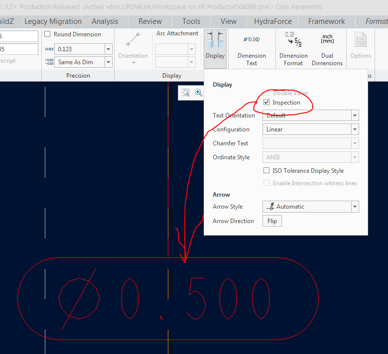

Inspection using rounded box works for me:

@LawrenceS:
Rounded boxes work for inspection dimensions, but not in texts like e.g. in notes.
Rectangular boxes in texts work by using @[boxed text@]

bobjohnson35
(To:StephenW)
Stephen,
Thanks for the link to the video - thats exactly what i was looking for (not sure why PTC support wasn't able to just point me to this...). It looks like they have moved to MBD for creating gtol datums and attachments as annotations.
This what the datum properties menu in drawing mode in creo 4 looks like:

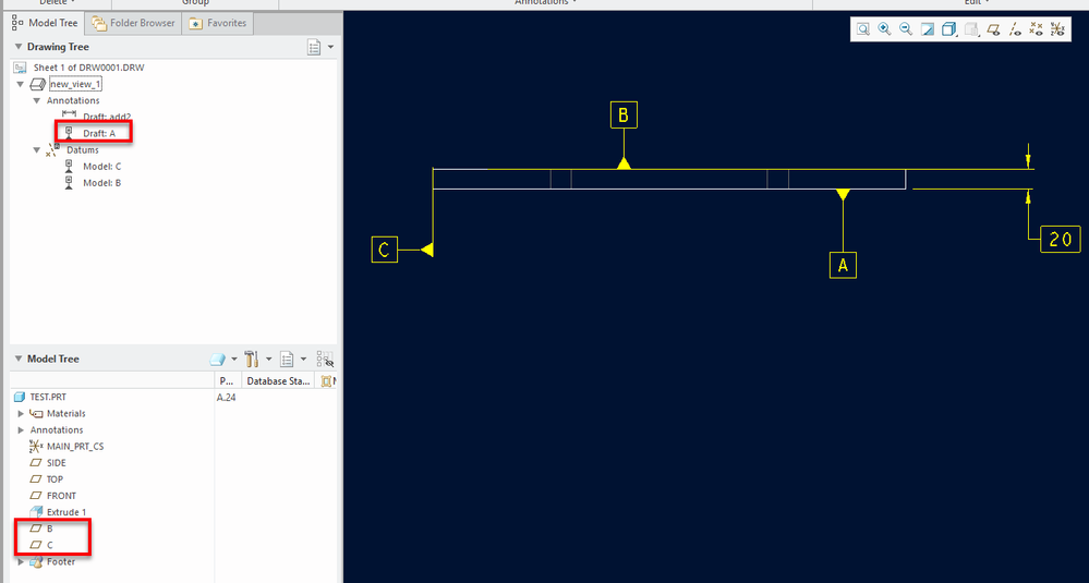

Bogdan
(To:bobjohnson35)
I have updated to using CREO 4.0 M060 and now you can create the datums in the model also and bring them to the drawing. Datum A was created in the drawing and doesn't have a feature in the model. Datum B and C were created in the model and bring them on the drawing view. In the drawing tree, you see the datums are in different "groups", the one created in the drawing is seen as a draft and shown in the Annotations group and the ones from the model are in Datums group.
Bogdan M
GaryLinscheid
(To:Bogdan)
Set the config.pro option default_gtol_owned_by_model to yes
Add the config that @GaryLinscheid said but also - don't create feature datum symbols in the drawing. They are not parametric to the GTOLs. Also use the datum feature symbol icon in the annotate tab of the ribbon. Don't use set datums defined by datum planes anymore. PTC has changed the workflow to better mesh with model based definition (MBD). Embrace the change now even if you are not using MBD and save yourself headaches later on down the road.
