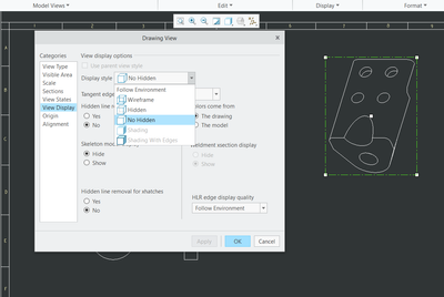

Hi
I am following the tutorial steps and I am trying to select the shading from display style for 2D. However, the system does not allow me to select it. Is t

Can you select it in the model itself?
I am not sure. I can select it from the mini tool bar on the top of the drawing window

My guess the view has a cross section. You can't shade a view with a cross section added.
no cross section

Do you have the following config option enabled?
enable_shaded_view_in_drawings
yes. This is enabled
Hi @JW_10714096
I think below is the only option to enable disable shaded views in drawing.
Please check again in your config file. Set above config to Yes.

I selected different models. All of them had the same issue.

please do following test:
  • create new General View in drawing
  • click View Display option in left pane
  • set Display style to Shading
Notes:
  • General View enables you to set Display style to Shading
  • some other view types does not enable you Display style to Shading ... what view type do you use?
