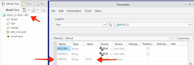

HOWEVER.....   Another (slicker) option - would be to try to get the PTC_COMMON NAME instead in the instance (a default column in the family table).  You can simply export to Excel, mass change these and save them back to the generic in I think.... 🤔
So - in your family table - you just populate the PTC_COMMON_NAME - as your model name (e.g. 12345_R = Instance Name, but 12345 = Common Name).

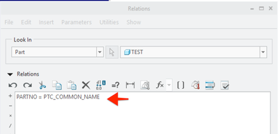

Then you can just set the relation without any string calculation - or worry about the "_" being there or not.
 PARTNO = PTC_COMMON_NAME
then it is done perfectly every time.
That might be a better solution to your issue.
