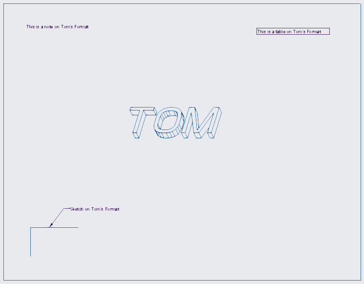

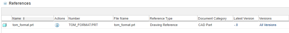

The Windchill dependencies are created during check in, so if the format does not exist in Windchill and is not accessible to Creo (not in session), then Windchill has no way to create a dependency link to it. In that case Creo will still knows the format is missing but Windchill does not.
For others who may be following this thread, here is a quick example showing what the drawing displays when the format is available and when it's not.
Format available:
Format unavailable:
Is above true for drawing and frm also.? In other words , missing frm (this frm contain items which are not embedded in drawing) and dependent drawing only would force me to break link of drw and frm before check in ? If it does not force me to break link of frm, mere drw check in without frm and later on check in of frm would result into complete drw file ?
No. While there is a dependency between a drawing and a format, Creo does not provide any way for you to break this link. If the format is not available, Windchill will still let you check in the drawing but it will not show any dependency between the drawing and the format. If this drawing was later modified while the format is available, Windchill will then create the necessary link between the drawing and the format for that drawing version only during the drawing check in process.
