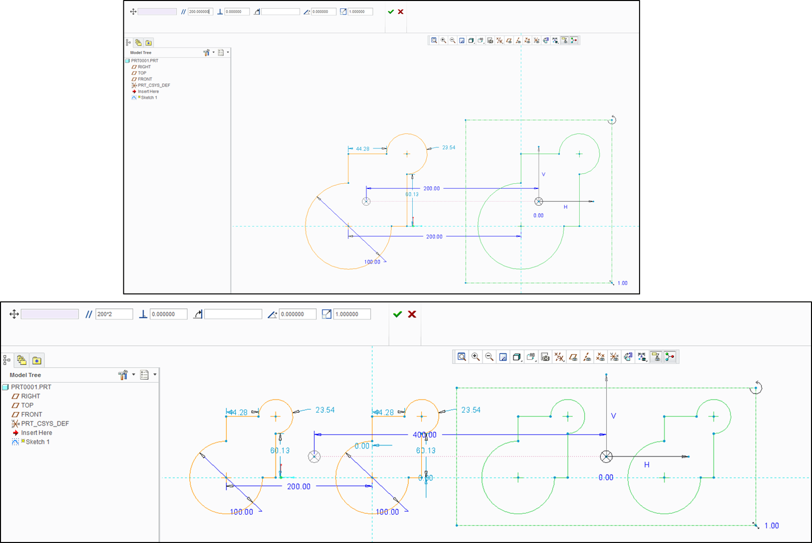

You can always copy paste the entities you want and then, select the first one and the copied one copy it again and paste it ad infinitum while changing the offset in the required direction. But, as pointed out in the other answers, it will complicate your sketch.sketch_pattern.png
