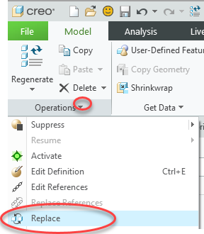

Why is Floating license needed to use replace feature in assembly. When picked new-assembly-interchange- OK
Error message: You have not checked out the license option. Please click "File->Options->Floating Licenses" and choose required option.
SEE IMAGE ATTACH

I think Interchange assemblies are specifically part of the AAX license.

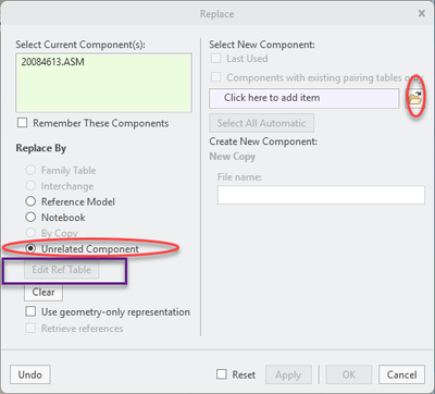

My first question, based on your post, do you need an interchange assembly or can you just use the "replace" function under Operations - replace and then Unrelated component and then choose your replacement component, then use edit ref table?  It creates a temporary interchange.
Interchange assemblies are okay if you need to switch something a lot of times

Youtube...here is one i found that shows the steps, its in a little older version of creo so a couple of picks are different.
He shows 2 ways to get the references paired, make sure you watch both since sometimes the "evaluate" won't help so you will have to manually select your references.
I haven't used interchange assemblies in years simply because replace does exactly what I need without the extra work of creating an interchange assy.
I also sugest you unclick the "remember these components" block since it will make a reference you may not want. If you are replacing the same items over and over, the "remember these components" will function similar to an interchange assy for future replacements.

If you want to permanently turn off the "Remember these components" box you can set:
remember_replaced_components no
Also you can get AAX for a lot less than $18k. Probably depends on the size of your contract and the length of the contract though.
