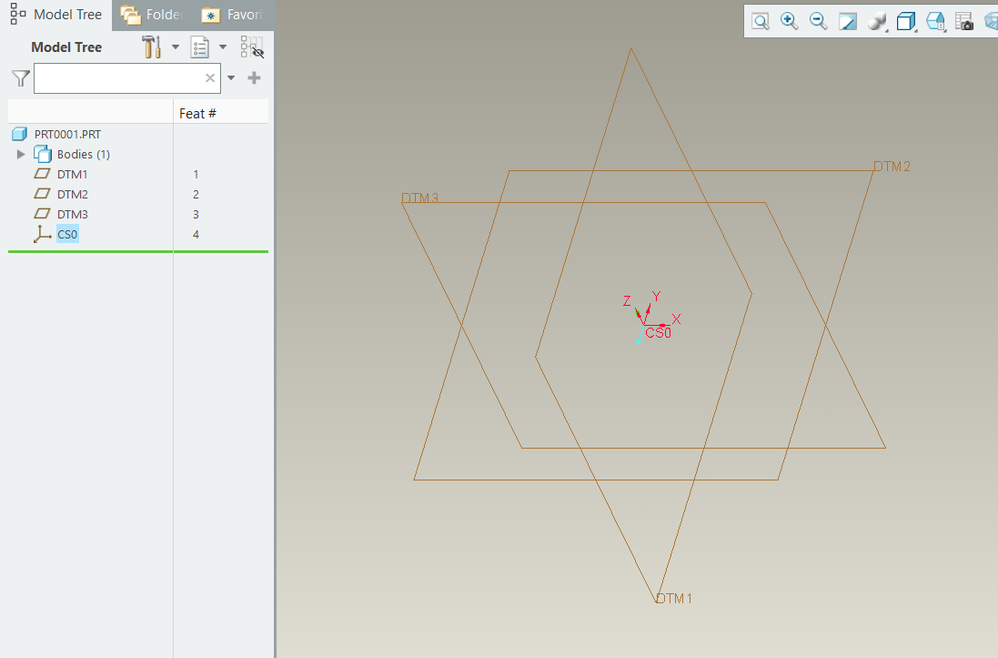

If you create a new start part, it is possible to orient the z-axis as required. Is this what you are trying to do? If so, the key is to create the default datums in an empty part before adding the csys to the model. See the model tree.
You can add CSYS features to control orientation and origin to support your workflow.  For your exports create a csys that has the z-axis oriented relative to the part geometry as required and use this csys for exports.
Use of a mapkey to create all orthographic views relative to a reference view is also very useful. The user will orient the model in a front view and then the execute the mapkey to generate all other orthographic projections for the model and save the views.

aha, so I will have to manually pick the only visible coordinate system in my model when exporting (to not default in to the invisible standard csys). Or as you say, use a macro.
Thank you for this work around! I will use it 😃

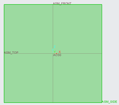

Thank you for the user defined view orientation. I will give it another try!
I tried this and at first did not like it, because I could not possibly get the orientation as I wanted. It can only rotate around X and Y and for some weird reason not Z.
This is the orientation I want.
As you say, the internal default csys will be where it is. I will just have to learn to use Y as forward instead of side I guess...
I guess I will never understand why I have the option to add my own csys, and then Creo just ignores it and use its internal default csys anyway haha
