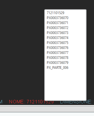

In this assembly I added many parts (they are for a welded carpentery):

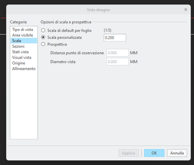

If I want to change the scale of a component, I have to select the component from the above list, then change the scale, then select and go back again to the main assembly.
But if I place the view and I change the scale in the view options, it allows me to change the scale of the view in a fastest way:
Creo adds a note with the view scale.
I tried to add the part number to this note loading a saved note but it doesn't works.
Only way is to add the text directly, but this is uncomfortable.

FYI, it won't help save time with old drawings, but you can perhaps adopt this procedure for your new drawings:
First, prepare a file called "standard_standard_view_note.txt" and put it in your Notes directory
the note file will contain the following:
&PARTNUMBER
SCALA &scale_of_view_new_view
1) add model(s) to the drawing
2) activate a model.  add a generic view.  rename it to new_view, (and use the "default scale for the sheet").
3) after view is created, create a note from file (using standard_standard_view_note.txt above)
4) the note will show the part number and the view scale.  relate this note to the new_view
5) rename new_view to something that makes sense (e.g. name of the component in question).  You will see that the created note will automatically be changed
6) repeat steps 2-5 for the other views / components.
Now your view notes will automatically update if you change the scale of the activated model.
They will also update correctly if you change the view to use "custom" scale (system will also create that special view scale note - but you can just delete it).
Little bit of up-front work but should help when scale modifications need to be made - and naming your views is a good idea anyway 🙂

MartinHanak
(To:pausob)
Parameter scale_of_view_X is available in Creo 7.0.
See https://support.ptc.com/help/creo/creo_pma/r7.0/usascii/#page/detail/To_Show_the_Scale_of_an_Individual_View.html page.

giobar19
6-Contributor
(To:pausob)
Thanks a lot. It's not exactly the solution I had in mind, but it works well.
