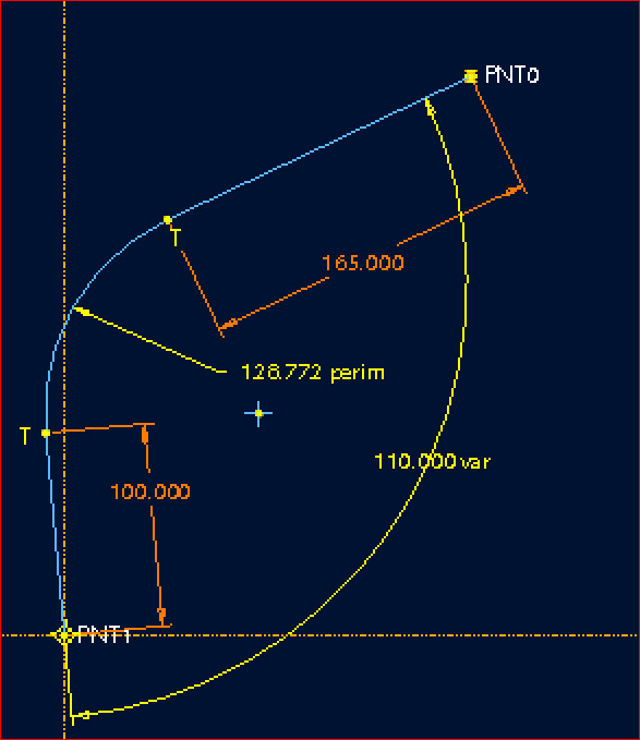

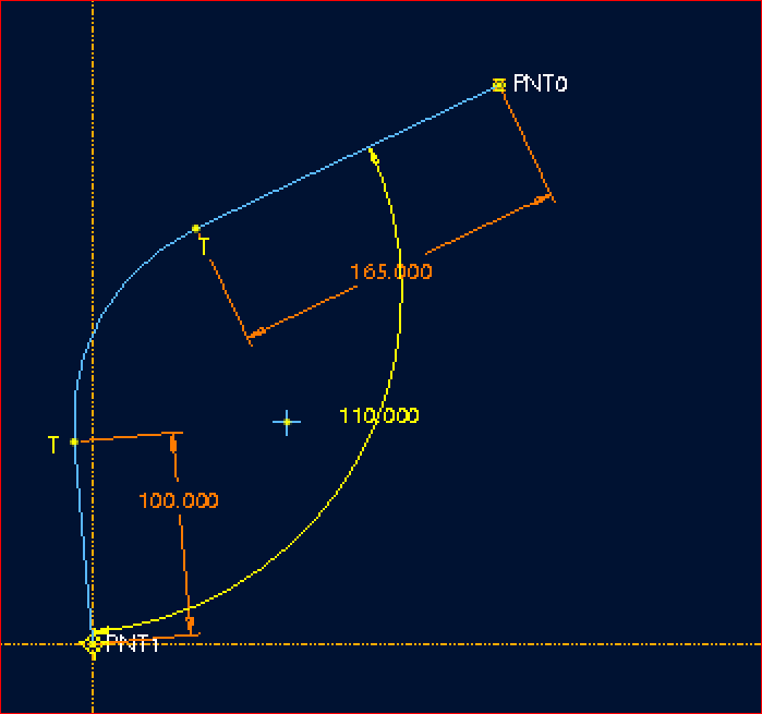

Hope this makes it clearer:
upload_-aW1hZ2UwMDEucG5n-1090512392718706214..pngupload_-aW1hZ2UwMDIucG5n-3383428589163942700..png
This screendump shows 2 rigid rods, length 100 and 165 respectively, connected by a flexibel hose.
The rigid rods are fixed to PNT1 and PNT0 respectively.
I want to assign a fixed value the the length of the flexible part in order to see how the curve changes when I move PNT0 in relation to PNT1.
I can calculate the arc length using the perimeter type dimension but I have not found a way to assign a value in a relation.

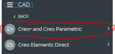

If the question is for Creo or Wildfire or Proengineer, then this forum is the wrong one.
PTC has two CAD systems:    Creo+ and Creo Parametric    and     Creo Elements Direct.
Which makes it confusing.
More, for Creo Elements Direct:
- The 3D software name is Modeling, and
- The 2D software name is Drafting.
For Creo+ and Creo Parametric, use only this tab:

The length of the hoses in these videos is not controlled explicitly in the sketch. It is done via the flexible component functionality. The OP is asking how to control the length in the sketch. @Chris3 has provided the key functionality to do this in sketch mode.
Create a perimeter dimension in the sketch for all entities and designate a variable dimension in the sketch that will update while the perimeter dim is held constant. You can see an example of the perimeter dimension in use in this recent thread: Re: CABLEVEYOR Mechanism - PTC Community
Watch the video I posted there.

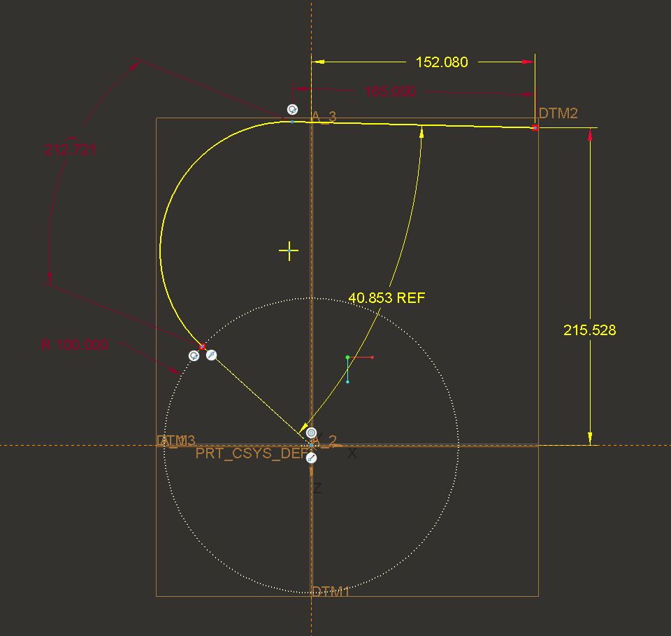

If you want to lock the length of the "flexible hose" then apply the arc length dimension in the sketch as shown here and lock it.
To add the arc-length dimension, click one end of the arc, then click the other end, then click on the middle of the arc, then finally middle click outside of the arc and you'll get a dimension. Note the "eyebrow" symbol above the arc length dimension below.

Many thanks to all of you!
The solution was to (in sketcher mode) convert the angle dimension to perimeter and add a relation locking this perimeter dim to a fixed value.
I had already tried this in part mode but there it was not possible to use the perimeter drawing in a relation – never mind why.
I might add that I am working in 1 plane only, the reason being that the hydraulik hose manufacturer recommends avoiding any twist of the hose.
