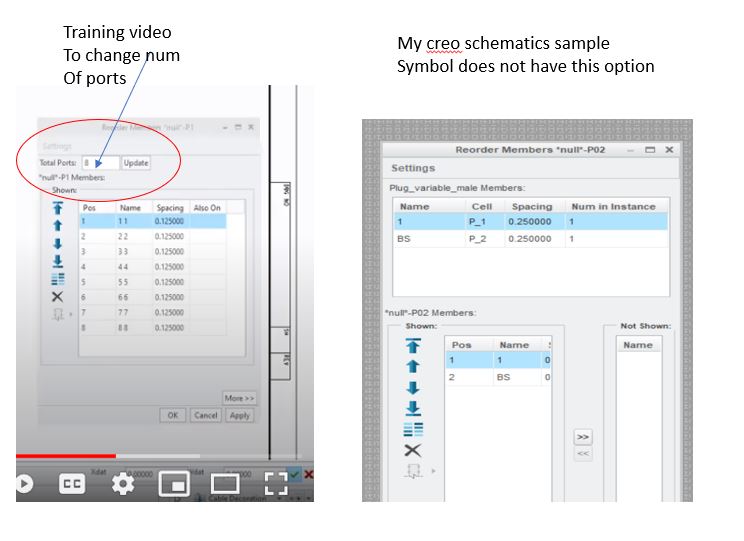

in a instructional video, it shows how to change the number of ports in placing a sample symbol,
my creo schematics does not have this option.
any thoughts?
see attached image.

Thus is the problem, if you can see my attached image here,
I don't have the option for "total ports", it just isn't here,
I assume I have the full version of creo schematics, I hadn't heard of a light version.

I missed your image and see that mine did not show up.  I will try to attach them.
Duh! I should have known you have the full version.  You talked about the cost.  Light version is free but only good enough to do some simple testing.
I should have asked which version of Schematics you have.  (should be able to be found in File -> Help -> About...)
Your Reorder Members window is very different from mine.  Hopefully you can see this image.
Does your connector groupshape look something like this, with the dashed lines in the Groupshape?
The dashed lines are part of a variable component.  They have to be very specifically created or they don't work.  For some reason the middle part is inverted.  That connector has the port number ABOVE the port when it is placed.

in the past few days I have found the magic click button
to add ports to a symbol, it's well hidden and didn't look like any one else's window.
obviously everything in creo schematics has to be set up before hand,
this is very time consuming and confusing.
