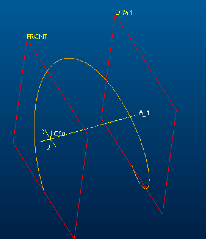

The screen dump shows a curve created in a cylindrical coordinate system with the equation:
r=75
theta=t*360
z=t*100
I am looking for an equation for z to make the curve ends parallell to planes FRONT and DTM1 respectively.

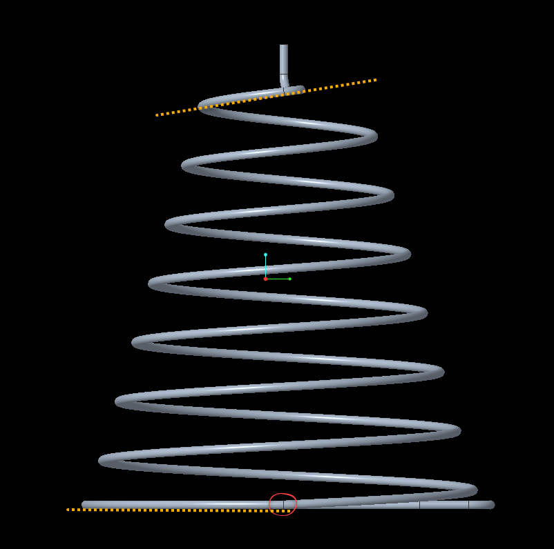

The picture clarifies what you need. If you use the parametric equation only to create the curve, I am pretty sure the answer is no as the trajectory of this type is not parallel to the planes at any point along its path.
I have had to deal with this type of problem with spring designs and you end up with a discontinuity as seen here to get a flat end on a helix. This is using a helical sweep, but it is the same issue. You will need to add some geometry that is not defined by the curve equation to get the transition to zero pitch. In this case you can see there is a kink at the bottom to go to zero pitch. When these are made it is not a sharp bend as seen in the CAD as the material has a bend radius.

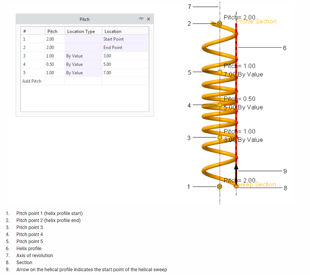

Here is a link to the Creo 9 help for variable pitch helical sweeps. It is table driven and the pitch cannot be zero in any table entry. It is not going to make it easy to get what you want using this feature.
To Set the Pitch in Helical Sweeps and Volume Helical Sweeps (ptc.com)

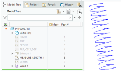

Well, one problem is that you're not telling us HOW tangent you want the ends of the curve to the datums (i.e. how many degrees of rotation dedicated to the transitions from the center section to tangent), and whether or not the interim section is a linear rate of twist or not.  For this, especially with the constant radius, I would us a Wrap instead of a graph-driven curve.  It's simpler to understand and do.  I did this in MM for you guys since I figured with the name (Swedish perhaps?) you guys wouldn't be using the superior inch system....🤣  I used 2 construction lines to ensure tangencies at both ends, and just did a spline for a smooth "S" curve between the ends and a relation using pi to make the length one complete revolution/twist.  You could use an arc (or conic) at both ends and use pi to determine how many degrees the transition took, with a straight line in the center for a consistent helical rate, or you could make the helical rate the driving feature (i.e. #degrees of rotation in a linear length of distance in "Z") and force the arcs at the ends to be a resultant of that, or any weird combination you desire.  In a wrap, you MUST have a CS in the sketcher or the feature doesn't regenerate.  Either way, here's a quick model I did for fun.  Enjoy!
Note:  The advantage of using a wrap is that, unlike using a graph, you can have any number of values/points in the Y axis for every point/value in the X, the disadvantage is you can't "easily" have a variable radius, and DEFINITELY can't do anything spherical.
Wrap may be an easier way to get what you want.
Creo 7.0 attached.

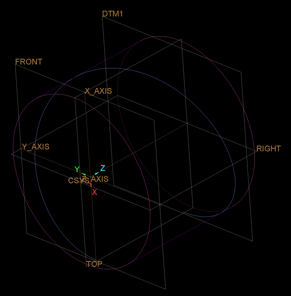

I have used your advice and created a datum curve as per attached file.
I have two new parameters:
numcoils = number of full 360°-turns
coilpitch = total height of curve
My graph control diagram as seen in ANG, gives the desired tangency at the end but at the beginning I get a stub in the revolve axis direction.
When I modify the ANG-graph to start as it ends the curve fails.
I have added a straight tangential curve at the top (curve_top_ext).
Next problem is that I cannot (=don't know how to) create a variable sect sweep using both curves together. I have made one (which is supressed) using the spiral curve only but have not been able to make one using both.
