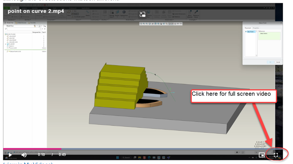

I suspect that the issue is with how you are selecting the curve when placing the datum point on it using length ratio. Use query select ( I think WF3 still uses query select) when selecting the curve to place the point on. This will present you with some options when selecting the curve. Make sure to select the whole curve.
This video shows how it is done in Creo 7. Query select is the functional analogue to the pick from list option seen in the video.

This video shows how to create the point along the curve in Creo 7. It should work the same way in WF3 although the UI selections will look different.

Sorry, but the video-texts are so small that I cannot read them.
Can you mail it to me (in a zip file to prevent mail problems) to bertil@rogmark.com?

tbraxton
(To:BertilRogmark)
If you are unable to read the video in full screen, let me know.

After I had restarted Proe 3 times and rebooted my PC twice, the Creo-Almighty decided I have had enough trouble and dutifully let me move my assy-point along the whole of the curves.
Ergo – problem vanished!

Full screen mode did not help.
