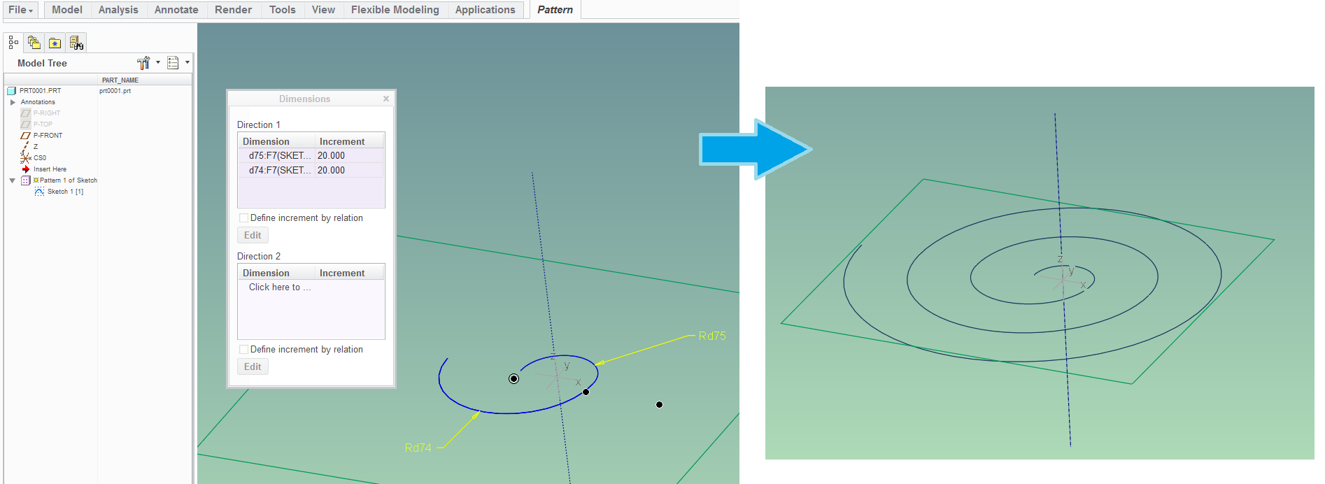

Hi how can I draw these spiral using Relations and Pattern features?
Best answer by psobejko
One way is to do a dimension-based pattern a sketch which contains 2 tangent arcs:
Rd75 = 10
Rd74 = 20
Both radii in the sketch are incremented in the pattern definition; so the next instance's smaller arc has the radius as the previous instance's larger arc...
I just sketched this example quickly and it worked out; but I don't know off the top of my head the formula for the increments that achieves the continuous spiral.

There is a small problem
June 8, 2016
Part of the problem is a spiral is not defined simply as two circular patterned and incremented as you have done they are specified by equations as Steve shows. You might get close with what you are doing but it's not a true spiral.

To make a spiral that behaves according to the original post's attached picture, I would create a datum curve by equation with cylindrical coordinates.
Input IR (Inner radius), N (Number of Turns), PITCH (Pitch)
Setup the equation like this:
/*  r =IR + t * (N * PITCH) , IR = Starting Radius, N = Number of Turns, t [0-1], (N*PITCH) = OR - IR, OR = Outer Radius
r = IR + t * (N * PITCH)
/*  theta = t * N * 360  , theta = angle, t [0-1], N = Number of Turns, 360 = full circle
theta = t * N * 360
/*  z = height  , 0 = flat, t * cos(r) = helical spiral thingy
z = 0

Like several other posts have said it wont be a true spiral using relations and pattern features. Why did you want to use these features?
The easiest way to do it is by a cylindrical coordinate equation, as posted earlier. Is there a reason you can't or don't want to use that?
