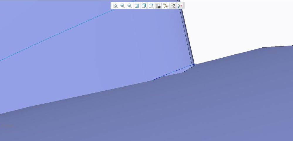

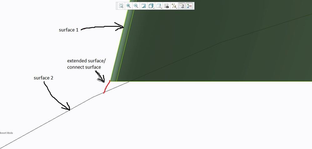

Hello everyone! I have a problem with two surfaces that won't connect to each other.
When i click on Surface Connect and click my Two surfaces.. Nothing happens when clicking ok.
Is there a possibility to solve this problem? Thanks in advanced!

I don't open RAR files so I cannot look at your model.
You can extend edges of your surface until they intersect as you want.
You could use Extend with "Tangent" option with Measurement "Along Edge"
