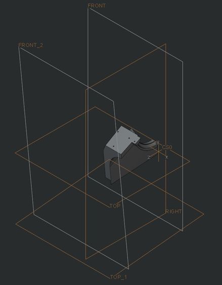

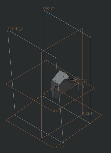

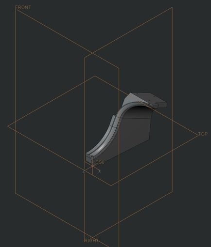

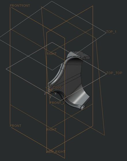

Not to belabor the point, but that wasn't what I was saying. In my experience the geometry is the same for all mirrors, regardless of how they were created.  Mirror by the FRONT, RIGHT, TOP or some other plane, assy planes or part planes or even just do a file > save as > mirror, they all result in the same geometry and same default part orientation.  I don't think that should be the case, but it is.  Given that, there's really no advantage in creating the assy and picking your mirror plane.  Just save as > mirror and be done with it.
Starting with this part, shown in default orientation:
and doing a Save As > Mirror, I get this, also shown in default orientation:
If I assemble it to a temp assyt and mirror about the part's TOP plane, the assy looks like this:
But, if I open the mirrored part, it looks like this, in default orientation:Capture2.JPGIdentical to the Save As > mirror part.  Selecting the top plane only effected its position in the temp assy., which I don't care about.
