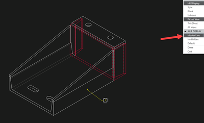

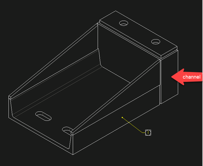

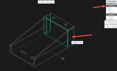

Component display is what you want but selection process here is the key. If you have sub-assy's, you want to make sure you are picking parts and not assemblies.
Simple example:
The part in the back is a c-channel, say i wanted to see that see channel hidden lines in the view.
Component display - HLR display - pick the part then OK - then change to Hidden lines,

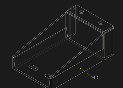

If you want to see "thru" a part, you'll need to use Style -pick the part, then phantom transparent for the part in front of the one you want to see.
Okay sort of figured this out.
Layout/Component Display
If you do HLR/Hidden Lines - The component will show Hidden Lines in all views but will not show internal components in assembled views (second image shown). You have to choose: Style/Phantom/Transp to see components. What I really want is Solid/Transp instead. I still want the solid outline of the rectangle!! This is how it looks:
Not a fan of solution. In this case I may just sketch the rectangle in sketch to fudge what I want.
