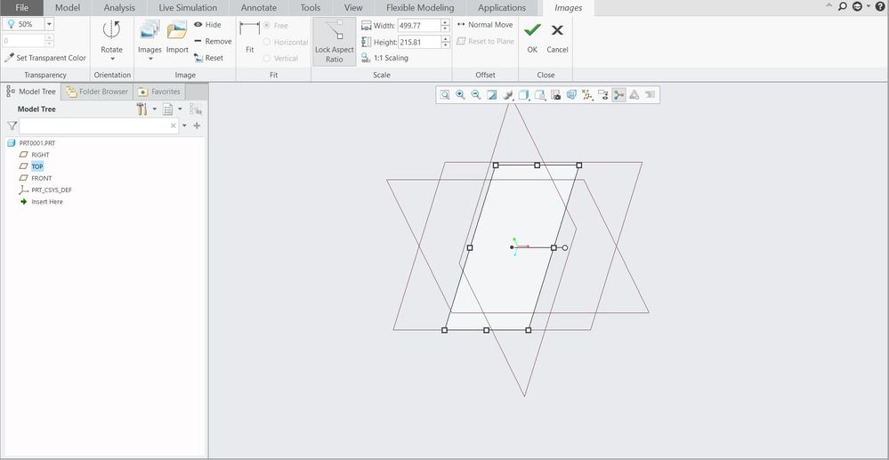

I am having a problem with importing the image using the view tab on Creo 5.0.4 and the problem wasn't solved even after I reinstall the Creo.
What I did is by clicking the view > model display > Import, the choose the image I want to display on a plane in Creo part file. It worked just fine but I had an issue with Creo start running slow after I close the resource center window, so I used the task manager to shut down the Cero parametric then reopen the file again.
The image failed to display and I won't work even after I re-imported, change the .jpeg to .bmp, turn on the .jpeg in paint and imported the picture into Creo, or even reinstalled the software. None of these works.
The imported image looks like this:

@HumphreyWu
Is there any notification or warning in message area? I think there will be that image cannot retrieve.
set config save_texture_with_model to yes and re-insert the image and save data.
I think details in article CS288145 will help.

Hi @Mahesh_Sharma ,
I tried to update the driver of my graphics card and it seems to work now!
Thanks for all the help!

Does the image appear scrambled? Look at this post
https://community.ptc.com/t5/Part-Modeling/Trace-sketch-image-problem/m-p/642880?search-action-id=46714953898&search-result-uid=642880
When I had this problem, I had to change the graphics card driver to an older version.
