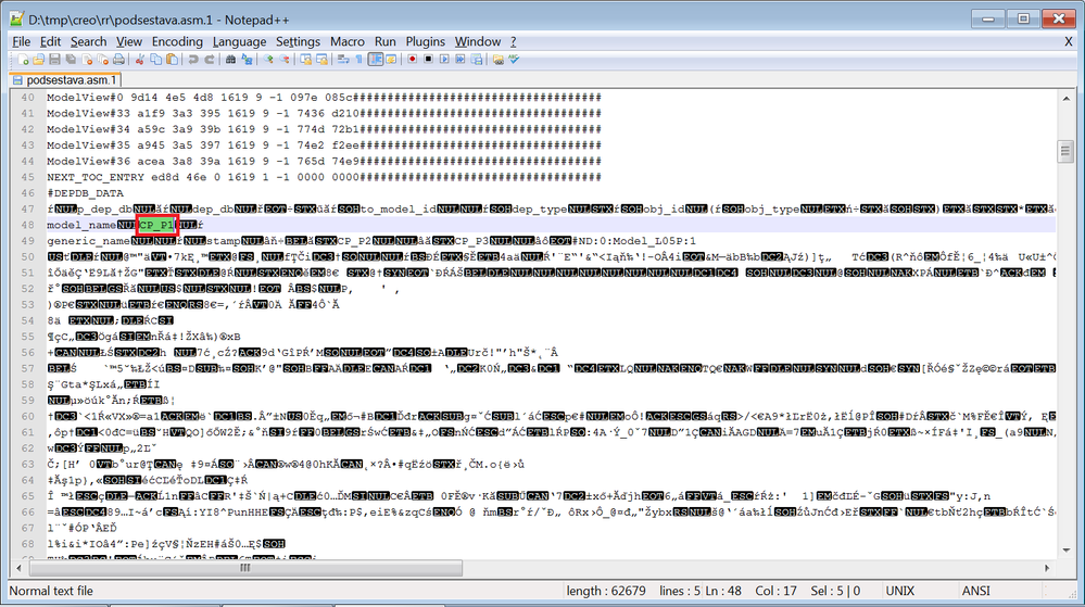

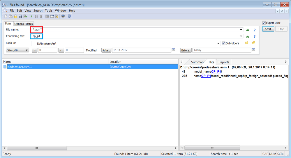

MartinHanak
(To:vojta)
assembly file (for example podsestava.asm.1) is mix of ascii characters and binary code. Component names are present in readable form when you open assembly file in Notepad++. See CP_P1 - name of component located in my podsestava.asm.1.
Because of this you can use for example FileLocator Lite software to "scan" the contents of all assembly files and look for specific component name.
Martin Hanák
