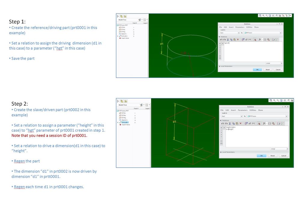

In case you have not got the answer. Here are the steps to extract a parameter value from a reference part:
I also attached the PPT and example files here for your reference. Hope it helps.

That's really what i was looking for. That really solves my problem.
By the way, You did an awesome presentation to show how to do it. Really nice job.

In the assembly context, it is relatively easy to find the ID (go to the "show" menu in the the relations dialog box).
So with your method, how does one determine the session ID ?
By the same way, via assembly. A temporary assembly can be created solely for checking the session ID of the part being referenced. The assembly can then be ignored, or quit without saving.
Note the same method can be used to retrieve parameters from data sharing part such as merge or inheritance. In this case, the feature ID is used instead of session ID.
