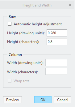

I couldn't able to change the table width( drawings units) and width (characters) on some of my drawings.
Could not able to type any thing on column section and it shows blank.

Column section is locked couldn't able to use.

I think you are selecting a single row of table and right Click > Height. If so, Width will remain inactive.
Select complete table (use filter or Window selection) > RMB > Height and Width, you should be able to control Width.
Still not working. 😞
I think you understand that it is very difficult to guess what's wrong with your specific table 🙂
Can't you really upload your drawing+drawing model?
