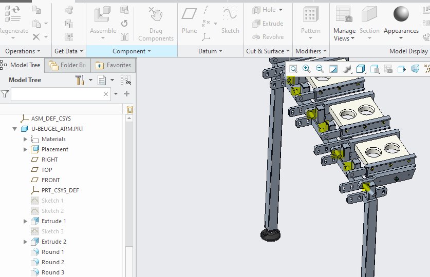

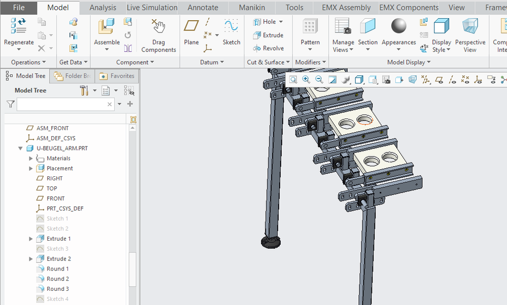

hey,
I have this problem when I try to drag a component while the component is defined correctly a component dissapears. In this case the black beraings as you can see in the first picture dissepear imediatly when I click drag component and I don't know why , can somebody please help me ?
thanks a lot !!
Solved! Go to Solution.

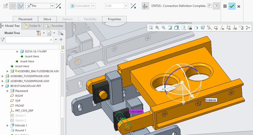

you had something strange in the imported "estm-16-174.prt" part .... replace your parts with the content from below/attached zip and fix the issues that fail on the top level assembly ... then it all works again
Assembly is saved in Educational format.
