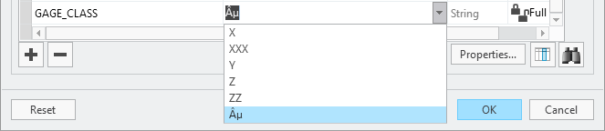

I am using Creo Parametric - Release 7.0 (connected) Release 7.0 and Datecode7.0.2.0
im new at this so maby this is not the correct place to ask, but is sure looks the best
when making a restricted parameter with a text document i use µ in one of the options, but in creo when selecting the option it shows "µ" instead of "µ".
i tried some other sybols and it does the same thing with the Â
annyone know whats going on?

it is indeed a problem with the UTF-8 that should be UTF-8-BOM
https://www.ptc.com/en/support/article/cs288478
so i did save as, and at the bottom you can change the UTF-8 to UTF-8-BOM.
after updating the restriction definition it works

I'm not sure if Unicode is supported in restricted parameter files.  Is the text file encoded as UTF-8?
WD_9815979
(To:TomU)
i dont know what unicode is or how to tell if it is encoded as UTF-8. but its a .lst file it thats what the question is
TomU
(To:WD_9815979)
I'm seeing the same thing.  You probably should open a support case and see what tech support has to say about it.
when you want to check this parameter with modelchek you will find the same problem.
only this time you need to change the coding from the text file with the list for modelchek to ANSI and not UTF-8-BOM
