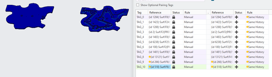

i'm making some updates to production parts and i've copied the relevant sub assems and parts to a new folder and renamed them.
i have 2 sub assems but they both use the same case and cover.
both sub assems have the renamed case and thats fine but i've not has sub assem 2 open when i renamed the cover. this means the one sub assem is correct and one is not. what is the best way to get the renamed cover into sub assem 2. if i use the rt click and replace, the parts below the cover, in the tree, all loose there placements. this seems odd as the part is almost identical to the original and was just made using a copy of the original.

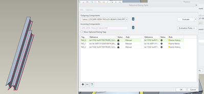

Use "replace" but click "unrelated component" and then select the replacement, then use "edit ref table" to select the references. Try the evaluate button first to see what it finds then any references not set, you manually select the reference on the new part.
i've never used this before an im not sure what the evaluate table is telling me. i have 10 tags and 3 of then have yellow dots in the 1st ref column and then 2 have yellow dots in the 2nd ref column?
StephenW
(To:doug_anderson)
Can you post a screenshot of the table?
something like this (as an example)
i've actually just removed the refs with the yellow dots and it appears to have actually worked.
1 of them was pointing at a feature that had gone for a wander. its not the best of models. there are assembly cuts that should really be part cuts and stuff like that.

hi, table below.
tag 8 the cut has gone awol
tag9 and 10 seem to not reference anything in the graphics view

Right, the yellow ones in first reference column are missing (but known) references or otherwise potentially a problem.
When your parts are save-as, you get good results from evaluate.
When your parts are not save-as, you will have to manually pick the references. With a large assy, I've picked over 100 references manually. Still way better than dealing with the problems one-by-one after the fact when you don't know where the problem came from.
