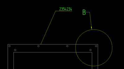

In a drawing I make a detailed views and switch the leader type (toggle leader type - above) and arrow style (to None) each time.
Please tell me if there are options in the prodetail that are responsible for these functions?

default_view_note_orientation  above_extended_elbow makes the detail view note above. above the extension
I don't see a setting for no arrow
default_leader_arrow_style  no_arrow will make note leaders without arrows
default_note_leader_type  std_iso will make notes above the leader extension
These all control creation and do not update existing.

Have you tried doing this with detailed view by yourself?
I just tried.
default_leader_arrow_style  no-arrow
This did not update existing notes.

Hmm, that's strange.
I tried it. Works only with leader.
Views, notes, dimensions, etc. all have their own DTL options.

@kdirth So, can you please tell me what view settings in prodetail I need to achieve my goal?) (to get the same view as the leader in the screenshot)

Thank You, @kdirth
default_view_note_orientation  above_extended_elbow works
How do you think? Maybe this is a hidden option?
If anyone can help with setting for "no arrow" I would be very grateful
I have not heard of any hidden DTL options.
