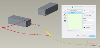

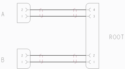

I'm trying to route two cables (obviously simplified example Smiley Tongue ). I got those modelled in Schematics and applied "USE_PATH"="PATH_A" to one cable ("ROOT" to "A").

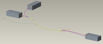

In Creo I created a network which is of a Y-shape. As connector "A" has to have a location which is _real_ close to the other connector, Creo Cabling wants to autoroute via this location, which I don't like. So I created a "Network Path" from the "ROOT" connector to the "A" connector and named it "PATH_A".
Creo Cabling doesn't seem to like it, the icon shows broken in the model tree and the cable is still routed the same way as before. In the "Route Cables" menu, the path can be selected via the "retrieve cables from logical reference" button.
Any ideas on how to get autoroute do the job and use the paths?
Thank you!

If you're trying to route using cables, as opposed to individual wires, there is a known bug in Creo Cabling for this.
Bug aside, the broken view of the cable in the model tree for paths is correct.
If you're not getting the path you want, why not try the 'Follow Cable' option and use your network, this will allow you to pick the locations to follow.

I tried to recreate your situation here and i was unable to get those paths to work as intended. Either it would always take the shortest path or the wire would break with no path found. Even just using wires instead of cables.
My suggestion with our business case is to terminate the network all the way to the coordinate system you are routing your wires to. That seems to create that link needed in most cases to resolve these network location proximity issues. Otherwise your only work around is to manually route the cable or move that location point closer to entry port of A.
There is also the location point priority settings.  I don't think they will help in this situation but it would be worth a shot to experiment with those.

Gotcha. Yeah you can't have that second point on the network too close. Here is what ours looks like. We have the network terminated to the connector on 1 coordinate system, no wires get routed here, it is just for the network. The wires route to their cavity coordinate systems. Then there is one offset point or coordinate system point for the cable jacket to terminate to. All this is done via importing an NWF and using the auto route feature.

So the jacket for us just auto terminates at the second location point on the network from the connector. So we have the location point at bundle entry which terminates the network. We will then have one location point on the network close to the connector that the jacket will terminate to. We don't designate that in any way, it is something built into Creo because the wire coordinate systems are off network so that is the closest place it decides to jump off network. At least that has been my understanding.

The jacket terminating at the second point in the network is my observation for like 95% of our cables. The other 5% are either shorter or longer and I did not find any logic behind that.
If I continue the network right up to the connector, it will route the jacket all thge way to the connector and add loops for all wires present. This looks like Creo does not expect any single wires in this case anymore and those are added later.
