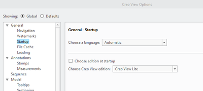

Open Creo View and under then open the Options.
Global Settings
General-Startup
There is an option to choose which version is started by default.

So there are no command line switches?  i know about the default switch, but if they want to use MCAD occasionally, they have to know to throw that switch,  then UNSET that switch next time they start.  i want to avoid that dialog.  we want 2 icons on the desktop.  the Lite version being the default when they click on a PVZ file.
