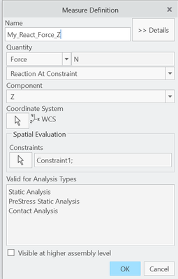

To get reactions, create a force measure. note: the constraint must be defined in the WCS (world coordinate system) to get reactions, but the reaction measure can then refer to any coordinate system for its direction. Using review total load is also a good way to verify loading, and the model does not need to run and have results.

First of all thank you for your reply. Can you tell me how to check the total reaction force in the output result? If possible, could attach the screen shot so that i can get an idea. Thank you

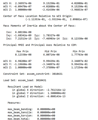

Without making any new measures, the result file will return the total load on the model (see below "Resultant Load on Model"). In many cases this should be enough to verify your input load to the system:

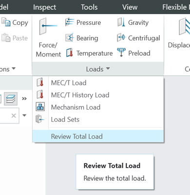

Also, reviewing the total load, as "SweetPeasHub" has suggested is also a great "pre-processing" verification.
