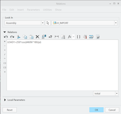

First create the parameter to hold the load value. (Tools Parameters - + )
Create User ParameterCreate User Parameter
Then show the angle dimension before entering Tools - relations so you can pick the dimension.
Then Tools-relations.  the angle dimension I have is d4696 but yours will be a different ID.  My example uses a cosine function.  Replace that with the function you need.
Define relation for load varianceDefine relation for load variance
Regenerate the model
Verify Parameter is now driven by a relation and locked.  Tools - parameters
Verify parameter is driven by relationVerify parameter is driven by relation

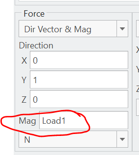

Now use the parameter by just entering its name in the load magnitude box.
Assign the Load with the parameter.Assign the Load with the parameter.
The design study would then as it varies the angle dimension, automatically update the load magnitude due to the relation and the parameter connection.

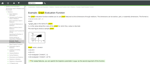

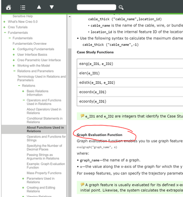

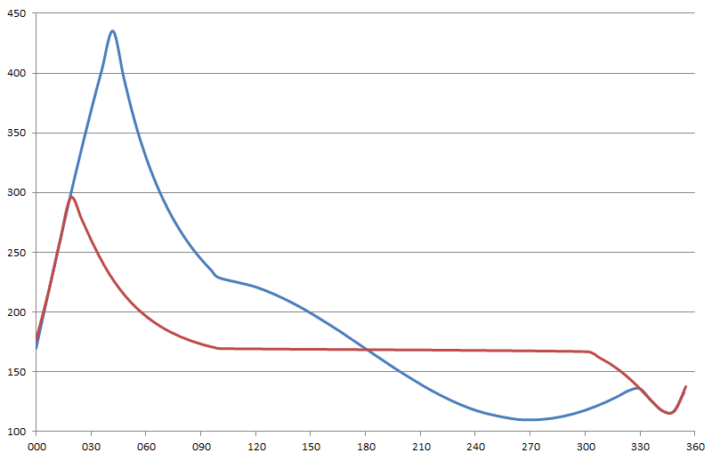

Thank you.  I think that's a good start.  But what if my function is more complicated than sin/cos?  Can I input a table?  This is my input torque curve, for example.
Awesome.  I'll look into that.  I swear I scoured the knowledge base for this...Thanks again

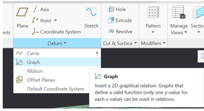

Hi, but with the Graph Evaluation Function you can only sketch and not import data (points) to correctly represent the plot. Or this last option there is and I don't know...
That's correct.  In order to input the data I had to:
1. Copy and paste the data from excel to notepad
2. Change the extension of the notepad file from .txt to .pts
3. Create datum points using the .pts file under "Datum > Point > Offset Coordinate System"
4. Create a sketch that connects the dots (points) via splines/lines
5. Save the sketch as copy (.sec file)
6. Create the datum graph by importing the .sec file.  You have to set up your csys orientation and origin appropriately.

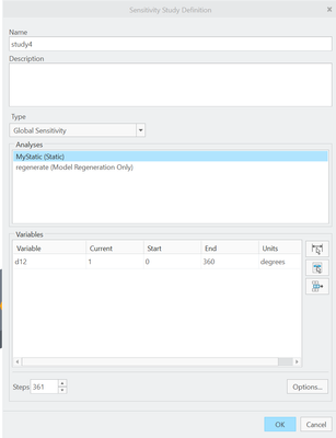

Hmmm...   Am I missing something here?  The only thing you can view for global sensitivity design studies is a graph.  Creo simulate graphs can be exported to excel using file save-as.
Design StudyDesign Study
This is what I would do for every 1 degree from 0 to 360 degrees.
d12 is your assembly angle dimension.
This is what I did and it worked well.

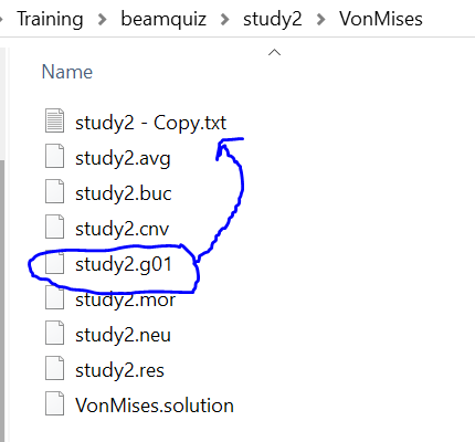

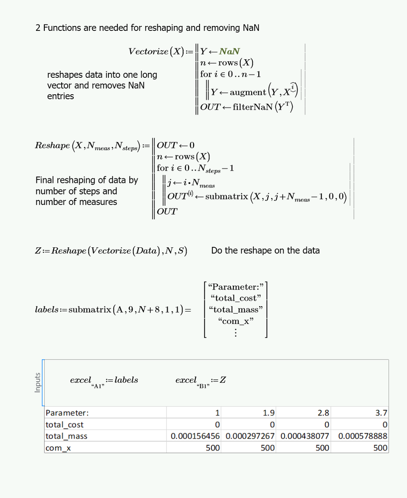

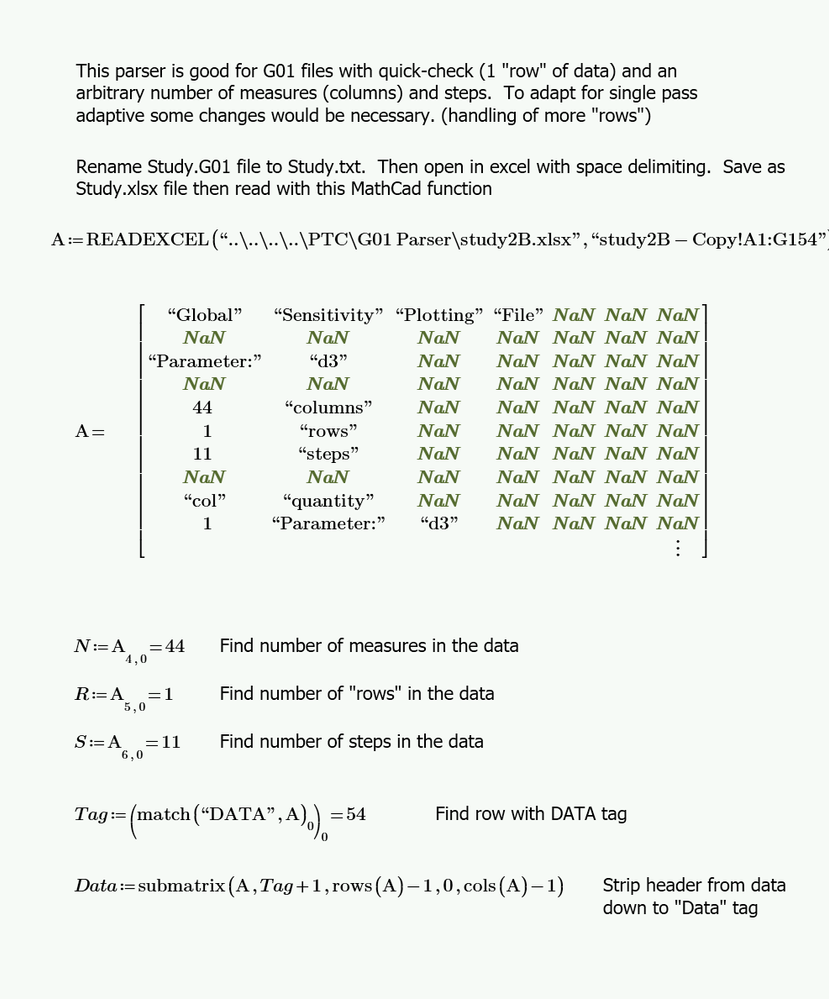

Here is a procedure to obtain all those 200+ measures in an Excel format.
You will find your measures in a study subfolder as a text file with .g01 extension.
You can open this with notepad to view contents.
The format is not ideal for Excel plotting so it needs to be parsed into a better format.
Here is my parsing method.  Use whatever programming language you prefer, some have built-in reshaping of matrices so that step will be easier.  I see now someone also posted a generic reshape function for MathCAD here.
1. copy and rename the g01 file to have .txt extension
2. import to Excel using space as delimiter.
3. save as xlsx.
4. Use MathCad parser below, Note: uses fully licensed version of MathCad Prime 5
G01 File rename for excelG01 File rename for excelParser part 1Parser part 1Parser Part 2Parser Part 2

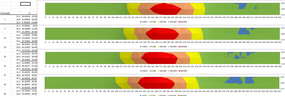

My .g01 file is from a sensitivity study.  I have 360 measures for max principal stress on the crankpin fillets for a crankshaft.  The study is measuring this data for every 6 degrees of crankangle rotation.  Would your parser work for this or would it require changes.
My goal is to create contour maps of the stresses.  I've completed some of it (see photo).  But it's time consuming and Excel has limited capability when it comes to contour plots.  I'd like to find a better way2019-04-30 12_33_12-Microsoft Excel - Sensitivity_Study1a.g01.xlsx.png
