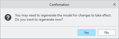

If you have a different dimension that you want to run, I'll recommend a parameter to drive it. This way, if you change a parameter under the Creo Simulate environment, it will ask you if you want to update the model.

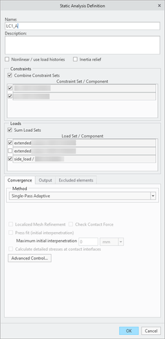

For different load cases, I create Load Sets for each need
and select/unselect per needs.
Create an Analysis for each different setup,

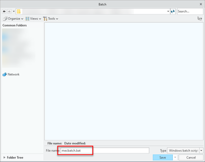

and create the batch file.
Save the batch file on your hard drive
For the second run, select the second analysis and bach. Save the batch file as the same file created by the first run. You will get a popup window if you wish to overwrite or add it. Go ahead and add it.
After you add all of them, just run (double-click) the batch file you created.
The batch file will run all your analyses one after the other in the order you create/add them.
