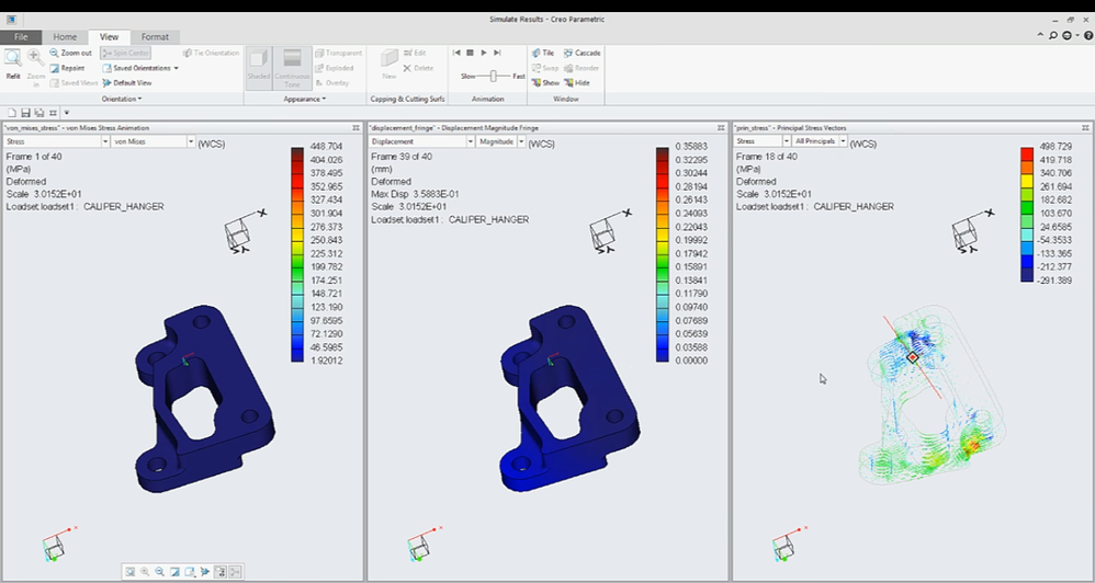

When you inspect a part using Creo Simulate, you can view your results in multiple windows. For example, the image below shows a Von Mises stress analysis, displacement, and principle stress vectors.
Great. But now, to inspect the model, you have to rotate the geometry in each individual window.
A series of unsynchronized results.
Wouldn’t it be handy if the system synchronized the geometry? That way, when you spin or zoom in one window, all of the others follow.

Synchronize Orientation Control
To lock and synchronize windows, just follow these steps:
  1. In Creo Simulate, open multiple display windows.
  2. Click View > Tie Orientation.
  3. Check to see which window is currently selected. Then, click on each of the other windows so they are all selected and tied together.
Now, rotation and zoom actions performed in any window automatically updates all results windows.2017-08-22_1909.png
A series of synchronized results.
