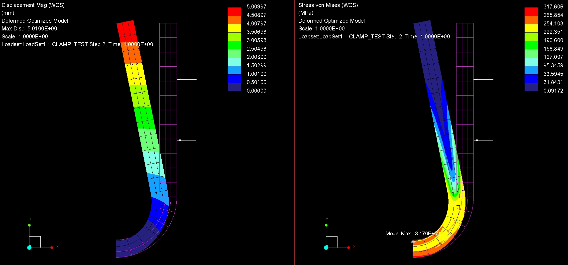

I have a following question: Is it possibile investigate with Creo Simulate the value of the force in order to "close"
the purple solid against the Yellow solid.I need a non-linear analisys, right?
Thank you for your help
20 REPLIES 20
Yes you want non-linear.  Large Deformation and possibly Elasto-plastic material

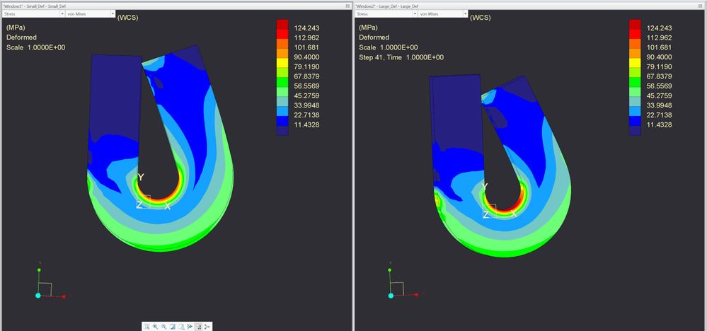

Here is the difference in small displacement and Large displacement (small on left)

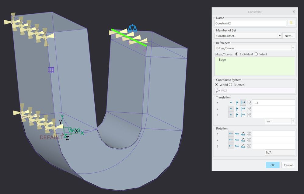

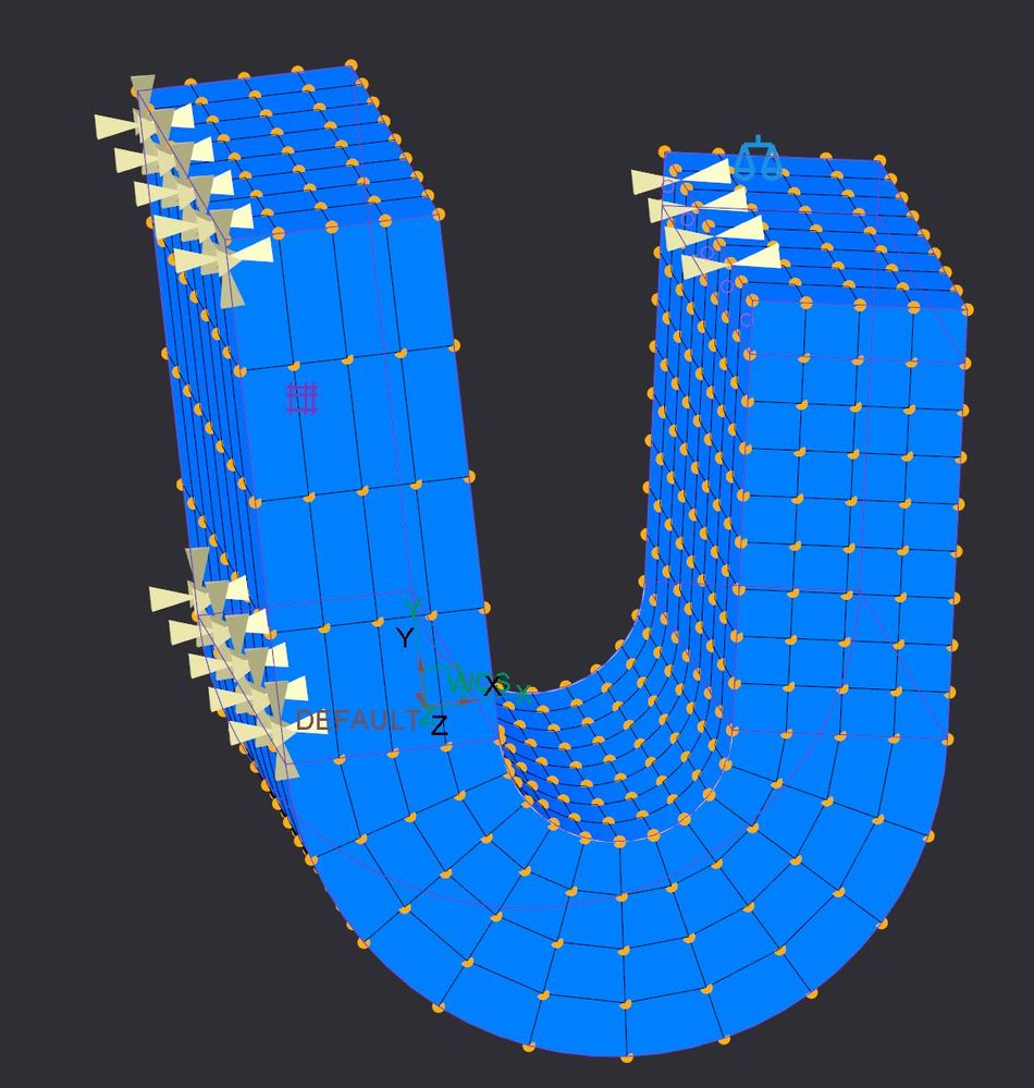

Here is how you do the 1.4mm deflection

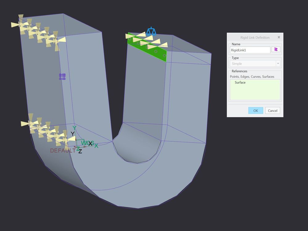

Here is how you prevent infinite stress at the edge constraint... with a small region made rigid.

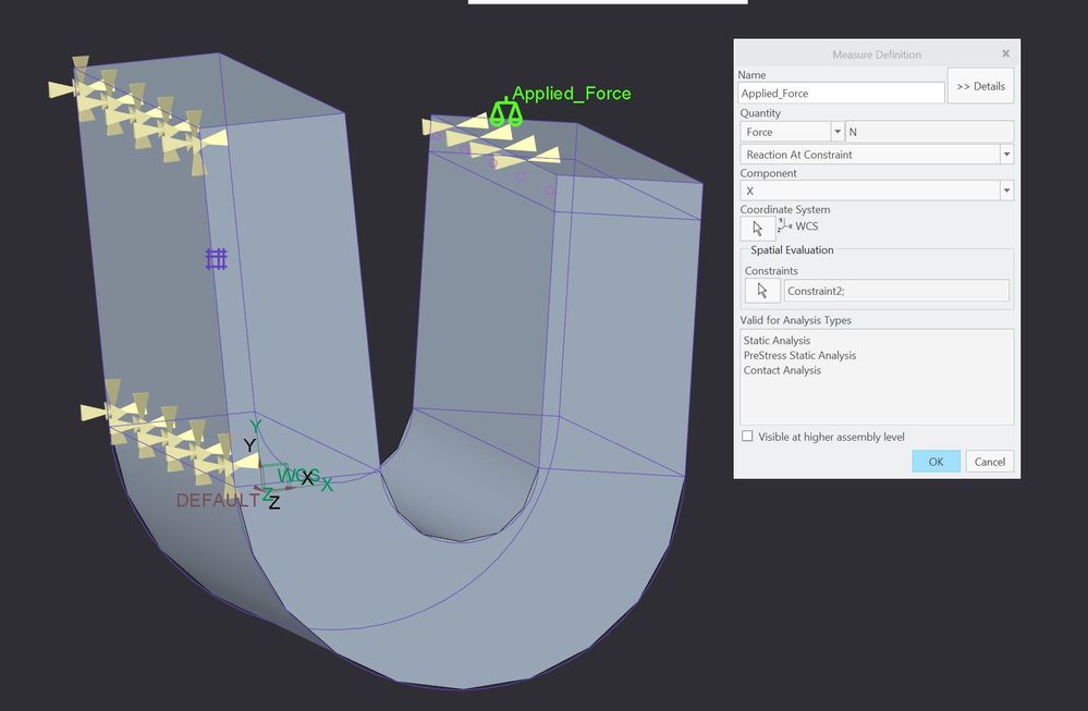

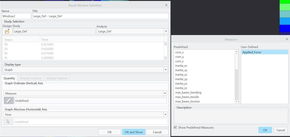

Here is the measure used to obtain the force.
Here are the Analysis definitions.  If using elasto-plastic material then Plasticity will have a check mark.

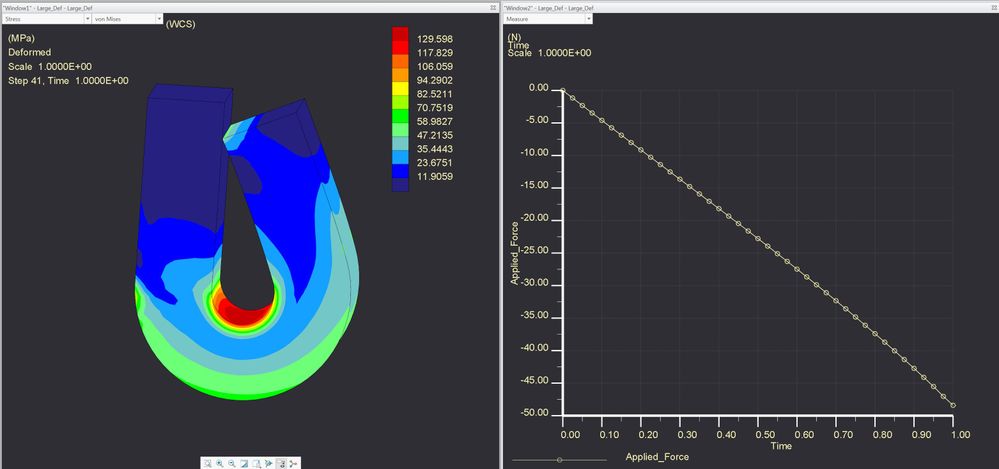

Plotting the measure vs. time
Final results.  If stress is above yield then you should use ELASTO-PLASTIC material.  Nonlinear material + non-linear geometry.  Otherwise force is generally predicted too high.
Confirmation?  Run this model with found force (48N in this case) in X direction as a load in place of the enforced displacement.  Confirm max displacement about 1.4mm in X direction.

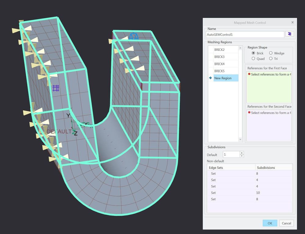

BONUS - I used a Mapped Mesh (not totally necessary but results are so smooooth!)

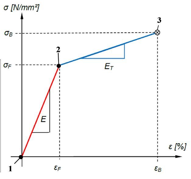

But for Use "ELASTOPLASTIC" material is correct this?
Yes.
Use creo help to understand elastoplastic in Creo.

Simulate said me that costraint and rigid link on surface region to prevent infinity stress is incompatible...
This is OK.  It is a warning, not an error.  Only use caution when this message appears because you may be asking the model to do two different things at same time.

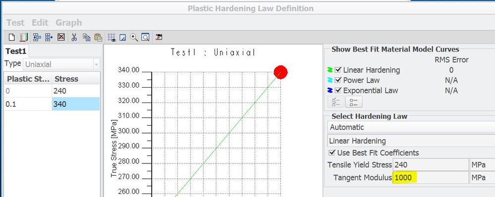

I used an elastoplastic material, but obtain this warning message with high stress

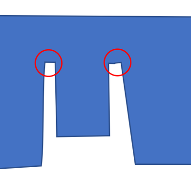

Please show more views of your model.  Is there a location with a sharp inside corner like this?
All inside corners near areas of interest should have at least a small radius.  For the plastic parts I work with 0.15mm radius is used.  Compared to H-elements, P-elements are less forgiving.  In H-elements the stress is averaged over the element size which hides the singularity until using smaller and smaller elements.  For P-elements the order of the element captures the high stress with larger elements.  You can artificially limit the order of the elements near singularities but I prefer a tiny, but realistic radius.

Finally element quality/number will affect the ability to model large strains.  A mapped mesh with quads and more layers through the thickness will help capture larger strains without too much element distortion.  A tetra mesh with large elements could contribute to the issue.

I try to improve my model, but I obtain again high stresses;
I added a small radius where the displacement occurs and mapped mesh

In this way the values  of stress down, but there is again the warning
"** Warning:
The stress is much higher than the yield strength of one of the
elasto-plastic materials in your analysis. Please review
your material properties and/or units."

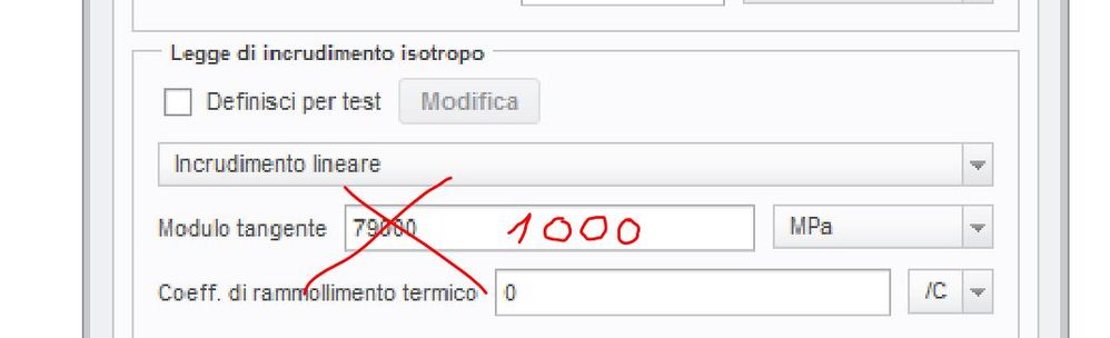

gfraulini
(To:skunks)
Where did you find this value (1000)?
The data sheet I mean.
skunks
(To:gfraulini)
it's approximately, circa
