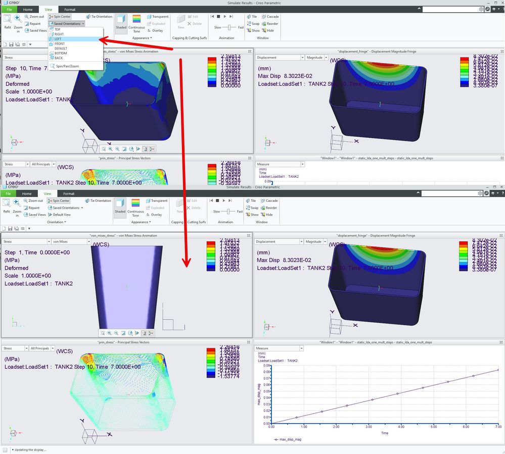

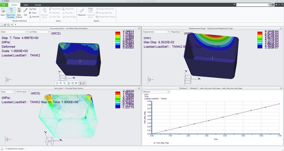

So when I open an simulation results:
here example above of static analysis with template provided by default in Creo simulate
So I could set a view /predefined in Creo Simulate:
Or I could use dynamic view

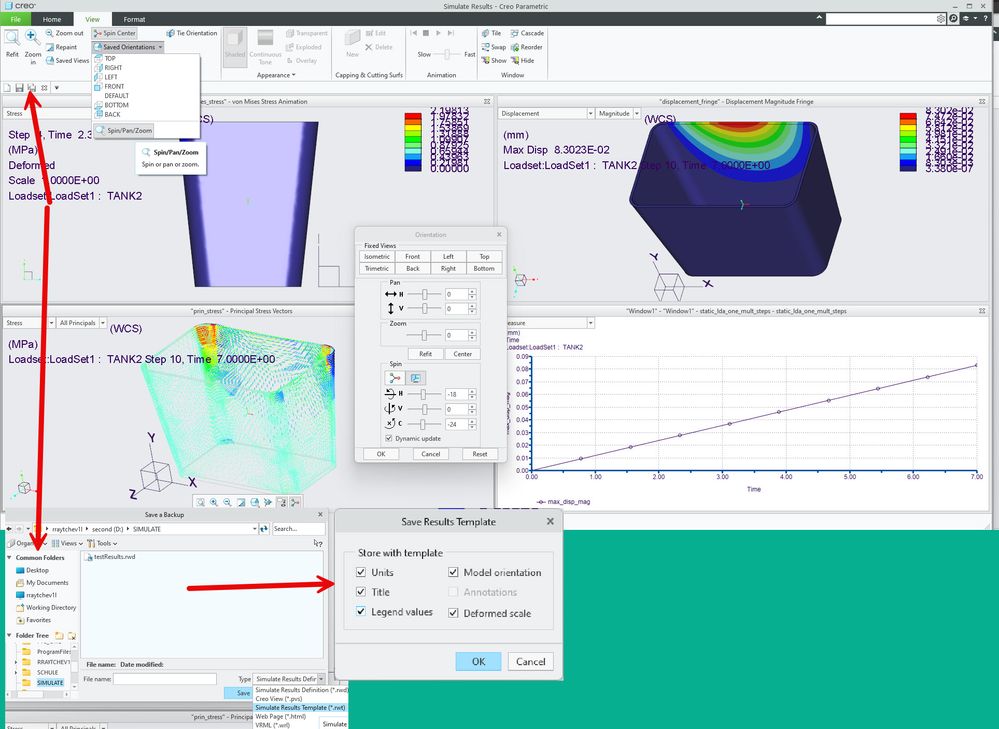

or you could use simple activate a view by click on the view  and rotate with the Creo  by mouse with MMB . Later when you have the desired display you can save it then to rwt template - where we need to check that it should save also the model orientation - means that what you want to change later via python directly to the rwt file
