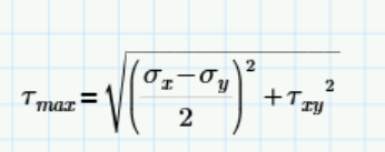

I don't use CSL but fundamentals are critical, which is why I am a bit reluctant about "democratized" and also approximated simulation tools such as CSL. It is more for quick, directional innovation than checking precise performance.
XY shear stress is not the same as maximum shear stress given by the torsional stress equation for a cylinder.
Reference Mohr's circle.
Standard Creo Simulate.
tbraxton
(To:SweetPeasHub)
This leads to my recollection of my undergraduate solid mechanics professor telling us that Mohr's circle is your friend more than once.
