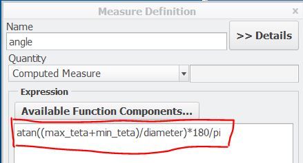

(To:DenisJaunin)
example attached
regards
paul
skunks
(To:skunks)
sorry, better:

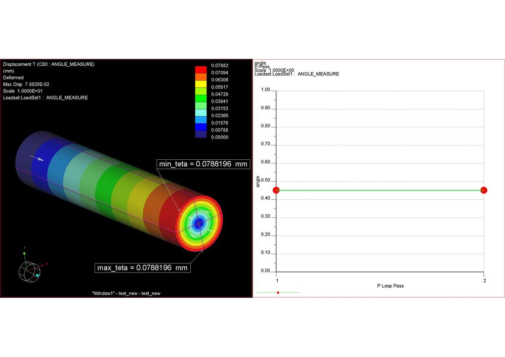

DenisJaunin
(To:skunks)
Hello, Pkloninger-2,
Thank you for your solution.
But can we trace the graph of angles calculated by measure?
Kind regards.
Denis
skunks
(To:DenisJaunin)
attached new modell:
