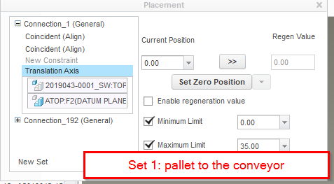

I will try to explain the design I'm making:
- we have a pallet (green) on a conveyor (red) with a lift in between (blue)
- when the lift with rollers (blue) is going up, the pallet (green) will be lifted when the rollers are touching the pallet.
I've done this with 2 sets of mechanisms on the pallet, but this isn't working as it should be...

The best I can suggest specifically for you is maybe you need another translation constraint before the "25mm pallet to lift".
Keep your "test" assembly as-is then
Redefine and add a 2nd general connection of the pallet.
Coincident  Test02:Front to Test01:Front (Align)
Translation Axis 1  Test02:Right  Test01:Right (-120mm)
Translation Axis 2 Test02:Top Test01:Top  (minimum -20 maximum 0)
Also, you can generate the CAM of Skunks with dummy reference surfaces so you would not need to modify your master CAD.  Fillets are just needed there for reference because of restrictions with CAM.  I often add dummy reference geometry to get things working right.
