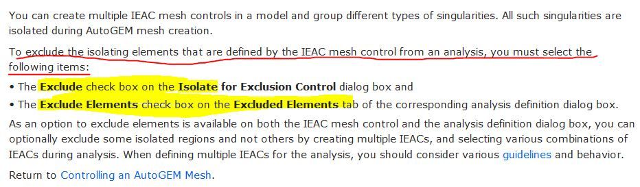

There is relation between "Isolate for Exclusion" (in mesh control) and "Excluded Element" (in "static analysis definition")?
Thank you
Here there is the relationship.
Bye
