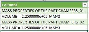

unfortunately there is no simple solution available OOTB.
Trail file method enables you to open ~500 parts and compute their mass properties. The results is ~500 files with .m_p extension.
3rd line in .m_p file contains requested information ... VOLUME = 1.2500000e+05 MM^3. You have to retrieve this information from ~500 .m_p files.
You can merge ~500 .m_p files into single file, import this file into Excel and use Excel functionality (PowerQuery) to retrieve requested information. For example:
