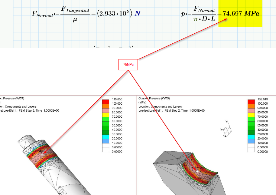

for my master project i need to do Modal analysis of press fiit shaft hub connection to find natural frequencies. I have used friction free contact for the press fit simulation.

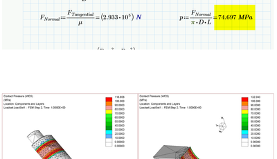

1. I found that the differnce between calculated contact pressure and simulated contact pressure is large

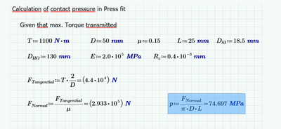

I ghave attached the CAD files and mathcad calculation in the folder. Any suggestions would be appreciated.

also when i am doing the static analysis with friction free interface there is deviation in contact pressure compared to calculated solution. Could you please tell what is reason behind the deviation in contact pressure.

thanks for your feedback, but is there any reason for deviation in mathematical calculation and Fem results about contact pressure..
In this case, which contact pressure is more accurate. Mathematical calculations or Fem results
there is no deviation, the results are the same

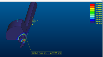

many thanks for your feedback. This maximum stress concentration (in red color), should i consider it as singularity affect ??
should i neglect the stress at hub edges in red ?
No, no, my model has notch relief,
the stresses are real.
