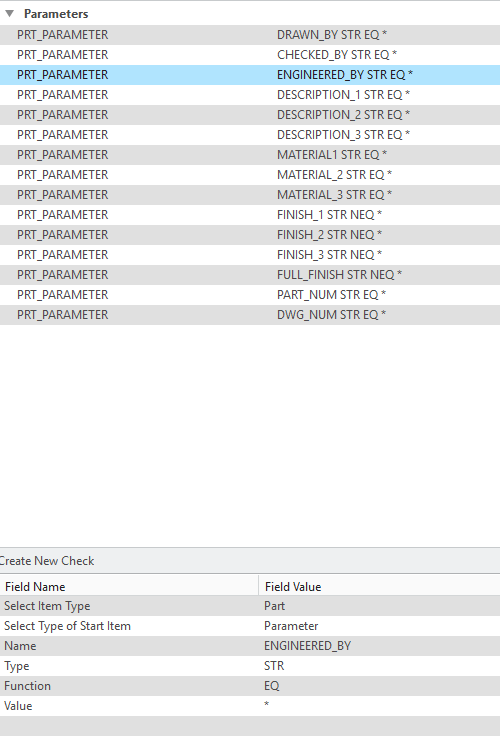

I'm trying add parameter for the Engineered by like the below format for my start file also added standard engineers list as well. But when I try to run the model check it is asking me to add the engineered by radio button alone not showing the test box and also not giving listed engineers dropdown list. Can you suggest me?
PRT_PARAMETER ENGINEERED_BY STR EQ LIST_ENGINEERS
I tried in an other way like at least if I could able to add the parameter manual entry but still there is some issue.
PRT_PARAMETER ENGINEERED_BY STR EQ *test*
PRT_PARAMETER DRAWN_BY STR EQ *test*
PRT_PARAMETER CHECKED_BY STR EQ *test*
PRT_PARAMETER PROJECT MNGR_BY STR EQ *test*
I am not able to add the parameters and suggestions would be appreciated.

Text file name for Engineers name list needs to be ENGINEERS.txt as you are calling the same in LIST_ENGINEERS.
Syntax seems correct just set the value to * not *test*. Possibly that will work.

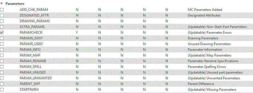

Also check PARAMCHK in check file, it needs to be Y

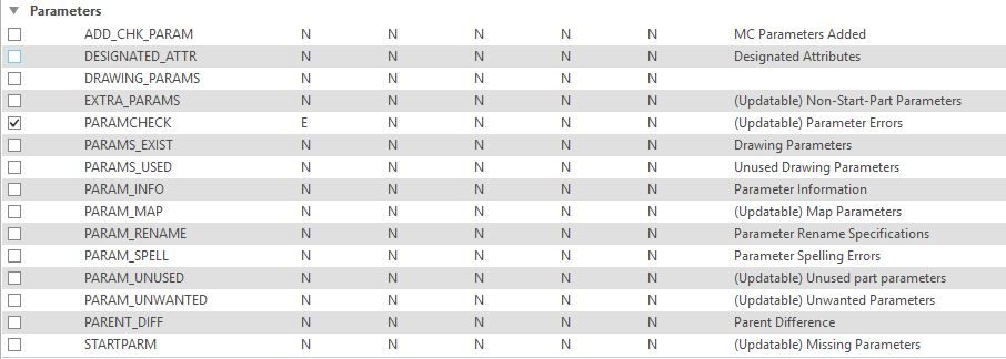

I tried the same way but still it is not working, see my attached settings.

Set paramcheck to E or W. Value Y is to check only it will display the results in information.

Yes, I tried the same, Not sure why it is not working.

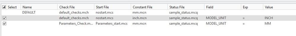

Do you have models in MM unit and are you customizing correct set of modelcheck files? If you are in maintenance, you may submit a case for tech support..

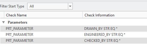

You need to create the list under the <model_check>/config/text

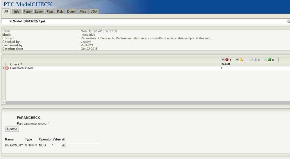

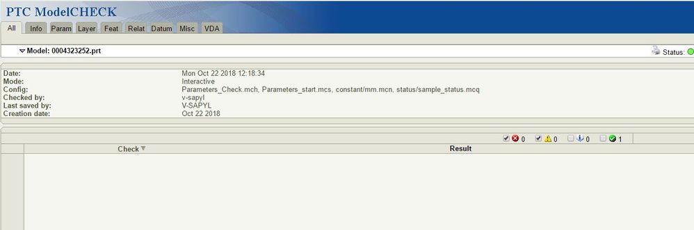

Yes, I tried for Layers and Datum set configurations it worked well.
But regarding parameters I'm facing issue. My models is in MM unit as shown in below snap.
If I set the drawn_by NEQ*, it showing error stating to add the parameters but after adding the parameters still the flag is showing. here is my example.

The unit is driven by the CONDITION.MCC I basically use the same config for both INCH/MM units

yes, I am using the same condition file .

If you don't want to use the list you can prompt the users to add a name:
It'll check to make sure there's a value or you'll get an error.
PRT_PARAMETER ENGINEERED_BY STR NEQ NULL

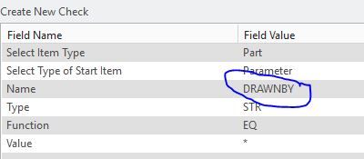

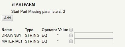

If I use the Syntex DRAWNBY instead of DRAWN_BY, it is working as shown in the below snaps. when I put *_" it is having some issue.
me why the _

As long as the parameter value matches it should work. Does not matter if you use "_" or not.

Ya, It's strange. Anything wrong with my condition file? Can you share your .inti & condition file? I will check it once

If I set the parameters like this it is working fine.PRT_PARAMETER ENGINEERED_BY STR NEQ NULL
