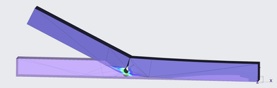

Suggested technique to enforce the gap closed as you indicate. Use at own risk.
This a technique when enforcing rotation on 3D because 3D elements only have translational DOF. (degrees of freedom)
Keep in mind strain results are logarithmic for large displacement.

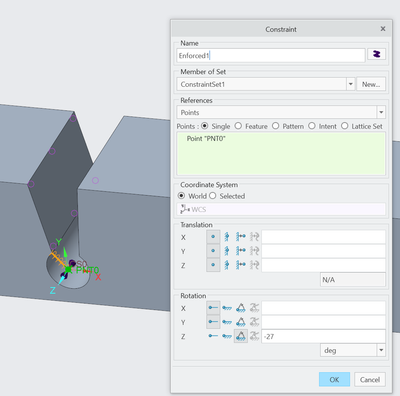

1. Coordinate system at center of rotation
2. Point on coordinate system

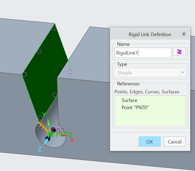

3. rigid link from moving section to Point

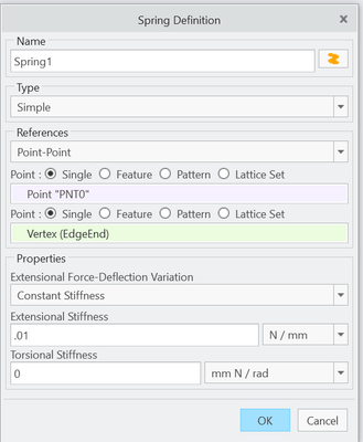

4. Simple 2 point spring from Point to anywhere. (very low stiffness)

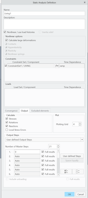

5. Constraint on the point to rotate the section the amount needed to close the gap. (may need to adjust the amount, radians or degrees)
6. Enable large displacements and enough steps to allow convergence (I show 21 steps, or 5% increments)
Hello, i didn't understand the need of the aplication of the simple spring in this case, since you made the connection between the point and the section with the rigid link, what was the need of the spring?
