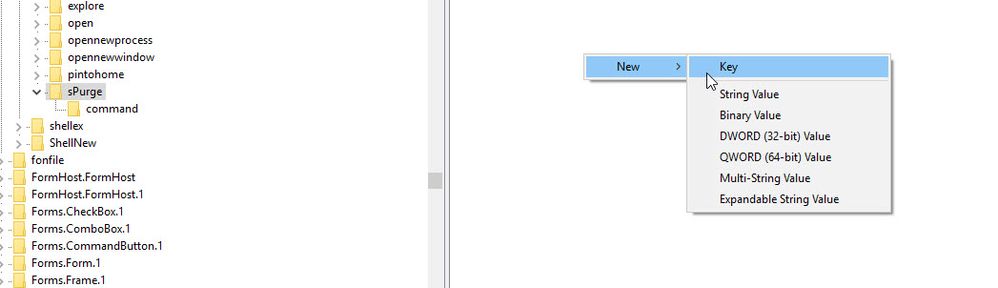

I saw this today, so after long time.. 🙂
You should have structure in regedit like this (Make new Key two times to get also command)
